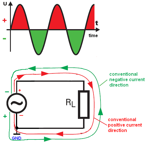

We can always freeze the AC voltage and treat is as a "DC voltage" maybe not literally. Because for example we can have a battery a switch to change the battery polarity and a pot. So we can very the voltage and change the polarity with frequency 50Hz.
For example if we have a sine wave signal source with the amplitude 10Vpeak and frequency of 50Hz.
So for t = 0s -->Vs = 0V so no current is flowing.
At t = 1.7ms ---> Vs = 10V*sin(314*1.7m) = 10V*sin(0.534 rad) = 10V * 0.509 = 5.09Vpeak
at t = 5ms --->Vs = 10V*sin(314*5ms) = 10Vpeak
at t = 10ms -->Vs = 10V*sin(314*10ms) = 0V
at t = 11.7ms--->Vs = 10V*sin(314*11.7m) = -5.07Vpeak
at t = 15ms --->Vs = 10V*sin(314*15ms) = - 10V
That only works when the frequency is low enough to allow you to ignore the reactive nature of any circuit. Once you have reactive elements, the relationship between instantaneous PD and Current is no longer proportional - because of the phase shifts involved. The internal fields in the circuit will be affected by these phase shifts. Many AC appliances have a Power Factor that is significantly different from unity.
