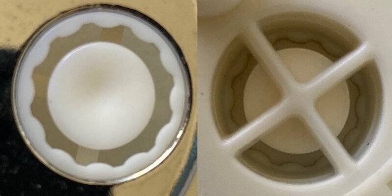

  • #35
Thank you. I had already figured that was likely the reason from the paper that Lnewqban linked where there is discussion of what they call the "eccentricity ratio" -- essentially how offset from the center the die is. I am actually about to build a pair of dies to test this out. I was going to post about it here once I'd finished testing them later this week.
In the commercial machines I found photos of online the pasta curved inward. Perhaps the explanation is essentially the same but it's not clear. As that paper pointed out there is more than one way to achieve a curve.
  • #36
JT Smith said:
I haven't used the pasta machine yet and was surprised to see a video of it where the round noodles came out curved. There is no apparent curvature or asymmetry to the die. It's a round (serrated) hole with a round center piece. Maybe my eyes are missing something.
The curve is outward from this die whereas all of the commercial ones I saw recently on the internet curved inward. Maybe it has something to do with how the dough is fed?
In arbitrary units, measurements from the core to the closest point on the fluted edge:
7 o'clock position: 0.237
8 o'clock position: 0.242
11 o'clock position: 0.272
Measurements taken with PhotoShop from an enlarged screen capture.
Inner edge of the metal part of the die measured 3.346 inches -- so scale the gap measurements proportionally.
Holding a ruler to the screen shows the diameter as 7 inches. The spacing difference is just visibly discernable at that scale -- if you look for it.

  • #37
Are you sure you aren't simply measuring an artifact of how the photo was taken (hand held smartphone)?
  • #38
Only moderately.
I was aware of that possibility, so I did a visual inspection and also checked how closely a circle in PhotoShop matched the circular die outline. Although I deemed it a worthwhile project, it could still be wrong!
Cheers,
Tom
  • #39
I wonder how good that circle test is? Seems like a good geometry problem.
If what you are proposing is true then the pasta will have slightly uneven thickness. More confusing is that the direction of curvature of the pasta is at about 3:30 in that photo but that doesn't correspond to the apparent thinnest area.
I took another photo of the same die rotated to approximately the same orientation. I wish I had a better camera but it's just my old phone again. I tried to center everything as best I could. The letters are an attempt to get the phone to focus on the surface. I think the pattern of apparent spacing is different now.
