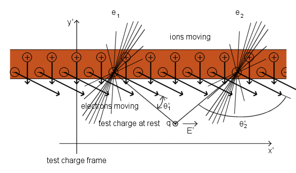

The reason why I expect that a field would be seen by the charge on the x-axis is based on what a charge would see from a wire approaching or receding from it:
Electric field from current in wire as it approaches a charge.
Similar but different to the above picture is our scenario in question where we consider what the charge on the x-axis "sees". In this case, there is excess charge on the tube enveloping the x-axis that is fixed in place, so there is no embedded current to speak of (i.e. no relative motion of positive and negative charges on the insulated tube). However, there would be excess charge of one type vs. another type, so a diagonal contribution would be expected from each "parallel strand" of the tube as the tube changes radius. The electric field contributions at the charge from all the "parallel strands" together would reduce to a "longitudinal" component on the x-axis, with all the radial(perpendicular) components cancelling at the x-axis. If my suspicions are correct, this electric field observed would depend on the relative velocity between the tube and the charge.

1) The electric field due to an imagined uniform charge distribution on the tube.
2) The electric field due to the induced currents / displaced charge density.
Since fields obey superposition, then it should be possible to say something about what each contributes to the result. I was contriving the problem essentially to justify focusing on 1 and to limit or trivialize the effect of 2. I am under the impression that I can form the problem so I can concern myself with only what the imagined uniform charge distribution would do in the axial charge's rest frame without having to complicate it by considering the effects of charge redistribution, which I am trying to minimize. It seems that you are telling me that I cannot do that in the problem.
In case if you missed this post, here it is again from above. It highlights my main concern. Of course here I am only considering what the bulk of the charge on the tube would do (i.e. the uniform contribution) under the guiding assumption that redistribution of charge can be made negligible by making the test charge on the x-axis of negligible value.
