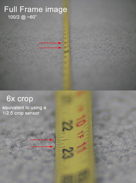

Ok, let's break this down, and you tell me how that is illogical:
See attached image for the formula of DOF.
"c" stands for the circle of confusion.
Now lets look at how the permissible CoC is defined:
"In photography, the circle of confusion diameter limit (CoC limit or CoC criterion) is often defined as the largest blur spot that will still be perceived by the human eye as a point, when viewed on a final image from a standard viewing distance."
https://en.wikipedia.org/wiki/Circle_of_confusion
The important part here is "largest blur spot that will still be perceived by the human eye as a point".
Now please tell me how you can add grain, or noise without changing the "blur spot"?
If you scale the image, change the viewing distance, alter the resolution etc. you obviously change the quality/size of the "blur spots". Therefore you change DOF.
If you still can't wrap your head around it... just go to https://dofsimulator.net/en/ and change the sensor size while leaving everything else the same.... DOF changes as you see. So why is that in your opinion?
