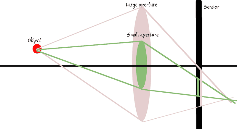

When recording the image, the main factors are size of entrance pupil of the lens and distance to subject but also the size of the recording format because it influences how much we have to enlarge the image when viewing it on our TV. When we view the picture on a TV, we have to take the distance from the viewer to the TV into account, the size of the TV etc.
No, the enlargement of an image has nothing to do with depth of field, nor does the distance between the viewer and the tv.
See the following image:
Notice the two colored vertical lines overlapping the sensor. They represent the spread of light rays of an out of focus object when they hit the sensor. The pink line, being larger than the green line, has more blur, and thus the green light has less blur. A camera using the green aperture would have a larger depth of field than a camera using the larger aperture because the objects out of focus have a smaller blur. That is, there is some amount of 'acceptable blurriness' before it actually becomes noticeable to the eye, and the smaller aperture increases this range by simply reducing the blurriness of unfocused objects (everything not near the point/distance that the camera is focused on).
And that's pretty much all depth of field is. Generally, stopping down the aperture (going up in f-numbers) increases your depth of field by reducing the size of the aperture, and vice versa.

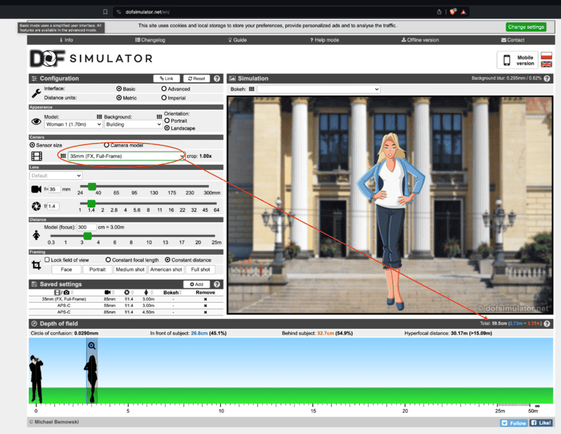

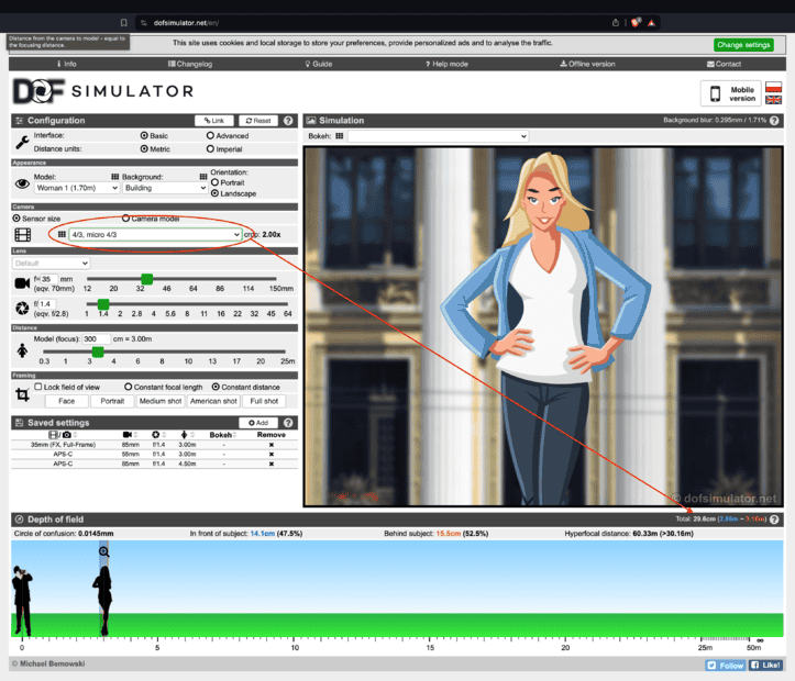

I think that is exactly where most people go wrong. Please take a look at the two attached screenshots of a DOF calculator. The only parameter that changed is the sensor size. This results in a change of DOF as you can see. So why is that? Simple... The picture recorded with a micro 4/3 sensor needs to enlarged twice as much as the picture recorded with the full frame sensor. Therefore, the permissible circle of confusion for the 4/3 sensor is half the size as the one for the full frame sensor.
Any comments?

After looking into this more, the issue boils down to how DOF is defined:
##DOF \approx \frac{2u^2Nc}{f^2}##
Here ##u## is distance to subject, ##N## is the f-number of the system, ##c## is the acceptable circle of confusion, and ##f## is the focal length of the system. The value ##c##, the maximum acceptable circle of confusion, is what is important to understand here. It turns out that the circle of confusion DOES change as sensor size changes. Per wikipedia:
Image sensor size affects DOF in counterintuitive ways. Because the circle of confusion is directly tied to the sensor size, decreasing the size of the sensor while holding focal length and aperture constant will decrease the depth of field (by the crop factor). The resulting image however will have a different field of view. If the focal length is altered to maintain the field of view, the change in focal length will counter the decrease of DOF from the smaller sensor and increase the depth of field (also by the crop factor).
I could be mistaken, but my understanding is this: Take an image. To define the maximum acceptable circle of confusion we need to say how big the image is. If the image is very small, such as when displayed on a small screen or a small piece of paper, then the blurring will have been 'shrunk down' very small when compared to displaying the image on a much larger screen or piece of paper. Imagine an image projected onto the side of a building. If you stand very close then no part of the image will be acceptably sharp and you'll need to move waaaaay back make it look good.
So there is an assumption in that calculator that the two images are being displayed at the same size and being viewed at the same distance. This would mean that the cropped version is having its image magnified by 2x, which increases the diameter of the blur by 2x, which reduces the depth of field since parts of the image that used to be acceptably sharp are now not.
So yes, sensor size is part of what determines the DOF of a system, but in a roundabout, counterintuitive way.
