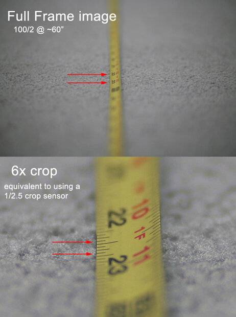

  • #64
Credit: Steven Kersting (https://photo.stackexchange.com/)
You can clearly see how the DOF changes simply by enlarging the picture. Especially noticable if you look at the carpet.
  • #65
Contrived case. Carpet is almost pure noise. Our brains have a rough time picking clarity in noise.
But the tape measure makes my case. Depth of field has been preserved across image resizing.
In both images, only 22 and 23 appear in-focus. And that's unequivocal. QED.
No, even in the tape measure it is clearly visible. You only get about 3mm of DOF in the bottom image... and about 10+mm in the image on top.
  • #68
Oldhouse said:
No, even in the tape measure it is clearly visible. You only get about 4mm of DOF in the bottom image... and about 10+mm in the image on top.
I see 22 and 23 (or 10/11) legibly in both pics. I see no other numbers legibly - in both pics.
If you blew this up to 400 feet - or shrunk it to 2 inches - only 22 and 23 (10/11) would ever be legible.
The DoF is preserved if you watched this on your phone or on the silver screen.
  • #69
