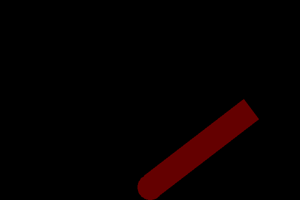

This is an academic project related to a falling object simulation.

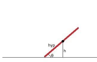

I have come to the point where I'm trying to calculate the per degree angle of the falling object seen in the attached images. The object has known height and length in pixels and is fixed on a pivot.
PE = mgh
KE = ½Iω2
I = ⅓ml2
Will calculate the difference in PE between two angles, eg: ΔPE = PE(90°) - PE(89°) = KE
So, ΔPE = KE
Δ(mgh) = ½Iω2
Δ(mgh) = ½(⅓ml22 (cancel m)
Δ(gh) = 1/6 l2 ω2
6 Δ(gh) = l2 ω2
ω = √6Δ(gh)/l2
Also, h is the height of the COM calculated at every angle using h = sin(angle)*hyp
hyp is the distance of centroid to the rotation point.
ω is measured in rad/sec
I'm confused on how to go back from ω to the actual animation of the falling object and also if what I calculated is correct.
Any help is very much appreciated.
Thanks

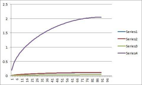

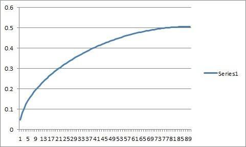

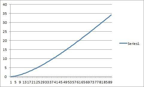

The list of ω doesn't look great though, I would expect to see some higher acceleration at the end - when the rod reaches the ground - rather than at the start of the fall. See the diagram of velocity-frame no.
In the equation of motion there is a ##\sin\theta## And your series 4 shows something looking like that ? But I don't really know what 1, 2,3 and 4 stand for...
Series 1 shows the ω for every degree (0-90)
sin(θ) is used to calculate the height of COM
Oh, well, series 1 also looks like a sine on that scale...
It doesn't look right. I would expect a different graph.
Namely ?
Yes you said that. But you still haven't said which is which or what you do to get these results.

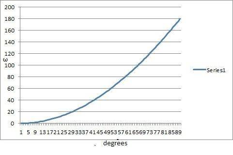

As long as you do ΔPE = ΔKE with respect to the same reference point. If that is the starting position in both cases you are relatively OK. Note that you run into trouble with the initial conditions very easily this way! ##\ \ \theta(0) = 0 \ \ \& \ \ \omega(0) = 0\quad ## is a (non-stable) equilibrium point: theoretically nothing happens.
If (your post #1) $$ {\rm PE} =mg{l\over 2} \sin \theta \quad
$$then $${\Delta \rm PE} = mg{l\over 2}(1-\sin \theta) \quad
$$and you easily get $$\omega^2 = {3g\over l} (1-\sin\theta)\quad $$which does increase nicely for ##\theta \downarrow 0##. So I don't really see a problem -- even for this very cumbersome method :smile: .

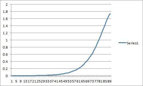

I see that, but I don't see why you think your thingy is wrong becasue you still haven't said what it shows. I only see a meaningless series 1, 2, 3, 4 and no idea what is on the abscissa. Should I read from left to right or from right to left ?
Can you show your steps ?

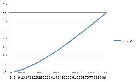

Sure. BTW, there is only one series (see attach). In this graph (x axis = frame no, y-axis = ω)
I have simplified the problem with a rod falling, not an object as in post #1.
So, here are the parameters and steps:
length_rod = 400
comDistance = length_rod/2
gA = 9.8
loop angle 90 - >0
com_height = sin((angle) * PI / 180.0)*comDistance;
//calculate angular vel of Pi
gh = gA*com_height
velP = (sqrt(3*(gh_pre-gh)/length))
gh_pre = gh
This is pretty much the actual process in the software. Let me know if this makes sense.
Thanks!

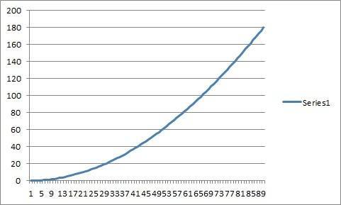

Code:
gh_pre = gh
should be
Code:
velP = velP_pre + (sqrt(3*(gh_pre-gh)/length))
velP_pre = velP
gh_pre = gh
in accordance with ΔPE = ΔKE with the previous point as reference. You could also take
Code:
velP = vel_0 + (sqrt(3*(gh_0 - gh)/length))
in accordance with ΔPE = ΔKE with the starting point as reference
Great! And now the diagram looks like that...
I did one run with height of rod = 100 and ω seems the same. I would expect that due to (sqrt(3*(gh_0 - gh)/length)) , when length goes up, ω goes down...
