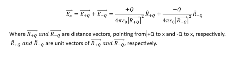

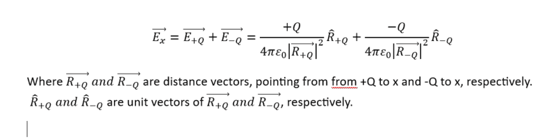

Hi there!
I have a question about the Faraday's Nested Sphere Experiment, please see the attached pdf. I wonder why equation (1) and the electric field's equation ( coming after (1) ) consider only the charge Q. Why there aren't charge -Q in the equation?
Ps. I'm thinking about point charges. When you have two charges: +Q and -Q, and you want to find the electric field at point x. You need to put both +Q and -Q in an equation:
BlackMelon
Because the flux density is radially outward for both (via Gauss's law) . For the outer shell this is into the local surface of the outer shell.
It is true that there needs to be -Q on the inside of the outer shell to kill the field inside the outer conductor. Thus +Q is left on the outside of the outer conductor before it is grounded.

I don't know, if it is so helpful to use such hand-waving arguments. Rather one should analyze the problem, using the electrostatic Maxwell equations. Since the problem is spherically symmetric, it's clear that the em. field everywhere has the form of a Coulomb field
$$\vec{E}=\frac{q}{4 \pi \epsilon_0 r^3} \vec{r}.$$
For the grounded outer sphere you have the outer surface at equal potential ##0##, and thus outside the outer surface the field is ##0##. This implies that at the inner surface of the outer spherical shell must be a total charge ##-Q##.
If you have the situation before grounding the outer sphere, then the total charge on both its inner and outer surface must be 0, because it was 0 before putting it around the inner sphere, and no net-charge has been in any way transported from or to the outer sphere. This is achieved by simply putting a total charge ##+Q## on the outer surface of the outer shell compared to the situation when the outer sphere is grounded. Thus in this case you have outside again the Coulomb field with ##q=+Q##.
