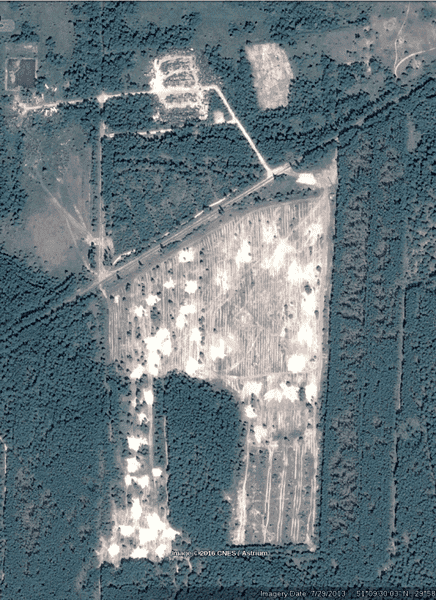

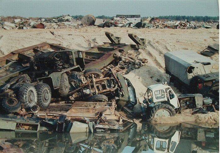

2013-07: everything "disappeared"
Yes, you see it right. Our former president's gang stole and sold even *radioactive* steel.
The steel itself is not radioactive even if fission isotopes have been dispersed on it, and those isotopes can be separated, mostly with detergents if someone takes the trouble. Also, what source indicates the vehicles have been sold into the steel market as opposed to being sequestered somewhere?
Common sense. The only plausible reason the vehicles aren't there anymore is that someone found a way to make money selling them.

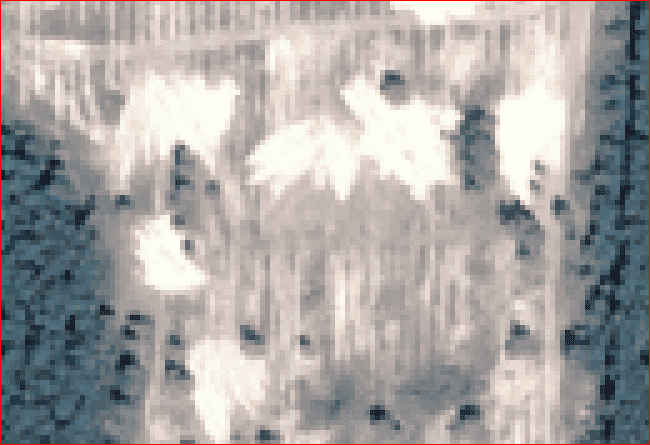

jim hardy said:
At 500% enlargement it looks more like somebody has edited them out.
I think it's just sand. The entire area has sandy soils (this also explains why local forests are predominantly pines, pines grow well on such soils). Here is another photo from that area.
Okay, It's possible I'm seeing where a bulldozer has covered up the junk with white sand
but you have to admit it sure looks like brush strokes retouching the painting, turning the junkpiles white and featureless.
Where'd you find the pictures ?
By searching the web, I find numerous testimonies that the place really is empty now. It's not a doctored map.
I made them myself: screenshots of Google Earth. GE has an option to see older maps (View->Historical Imagery).
