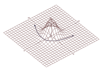

I'll suggest an alternative of the bowling ball/trampoline image that removes some of the improper analogy. Freeze the trampoline's shape and turn it upside down. Visualize a line of ants walking along the surface and then one's intuition that their path still must bend toward the center to take the shortest path makes clearer the geodesic aspect and removes the artifact of the "baseball rolling down hill since the trampoline has been depressed." which is not a GR effect in the model. An alternative to the ants is a taut string or rubber band held to two points on that surface thereby following geodesic. Something like this:
Much better than the trampoline! One frustration I have with visualizations like this, though, is that they leave out time. Which seems to leave out the equivalence principle.
