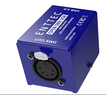

Something like this?
https://www.enttec.com/product/controls/dmx-usb-interfaces/dmx-usb-interface/
Yes! Except mine is just like their ENTTEC Open DMX. Same thing.
I only plan to sell within the United States. So FCC should be all I need.
I think that's right, unless you connect to AC Mains or are claiming isolation voltage like the first link that I posted.

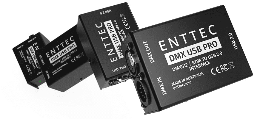

Like this one -- can you just use an off-the-shelf unit that already has the certification(s), and add value with your software?
I guess I just won't sell mine, that's the answer. But mine uses the 3-pin DMX output, which is more common. It also has some status LEDs which would be helpful for someone trying to debug their settup. Mine was a first attempt to learn the business, and now I know it.
