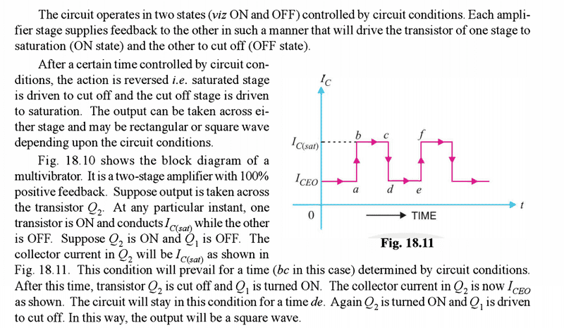

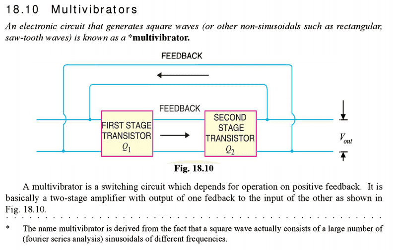

i read chapter 18 (switching circuits ) at (principles of electronics by v.k mehta) ..
section 18:10
he mention that the multivibrator is a two stage amplifier that work with a positive feed back .. i can take a screenshot if you need ..
the use of positive feed back at oscillators i already understand ..
That would help, thank you. :smile:
here is the photo of the beginning of the section
here the second photo for the rest of the section (the 1st one at previous reply)

To answer this question it is necessary for you to know the meaning of the term "stability" and to be familiar with stability criteria (Nyquist, Barkhausen,).
Intuitively, each harmonic oscillator and each multivibrator needs a kind of self-excitement (autonomous build-up signal amplitudes). For this purpose, a part of the output voltage must be coupled back to the input - without any phase shift: That`s positive feedback.

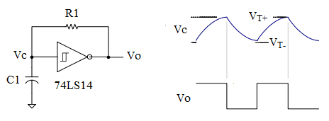

it seems helpful .. but at multivibrator say- astable- how the capacitor and resistor make positive feed back
Which circuit are you referring to? With opamp or with transistors?
Please, show the circuit. Otherwise, explanations are problematic.
Here is the simplest possible circuit for an astable multivibrator:

The multivibrator is described as an amplifier
but it has no input
meaning
its gain, output/input, must be infinite.
Since no amplifier can have truly infinite gain , in order to have an output it must get an input from someplace.
That someplace is from its own output.
It must get its input from a fraction of its output and that input must be in a direction to reinforce output not oppose it. And, that is the definition of positive feedback.
Were feedback in a direction to oppose further output it'd soon drive output to zero which is what negative feedback does.
When you study feedback they will explain that
An amplifier with gain A
and feedback B
has gain A/(AB-1)
note that when product AB = +1 the denominator becomes zero so gain becomes infinite and it'll make an output with no input and that's an oscillator..
but if product AB is negative , which is negative feedback, gain is always less than A.
For simplicity set A = 1 and plot gain for B = -1 , -0.5, 0, +0.5 and +1
