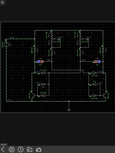

I am having trouble getting an astable multivibrator to oscillate higher than 480 KHz. I added a "baker clamp" which gave some improvement, but didn't get me to the target frequency of 816.5 KHz. I am on an iPad and can't post a schematic. I use 2sc6082-1e transistors and bat41 diodes for the clamp. Any help would be appreciated.

The transistor is not fast enough. According to pg.2 of the datasheet, the switching times are:
Ton = 52nS
Tstg = 560nS
Tfall = 37nS
. . . . . =649nS for each transistor; double that for two transistors = 1298nS or ≅1.3μS cycle time. That gives 770kHz maximum. Your transistors a little better than the datasheet so are operating a little faster.
Pick faster transistors.

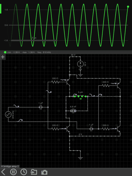

The second schematic is the load of the first, with the astable multivibrator replacing the 816 KHz ac source. It's the astable multivibrator driving an H bridge amplifier with a 5 uH inductor as load. The amplifier may need revision.

Yup. Connected that way you will lose all four transistors as soon as power is applied.
I have had it running for a few minutes, watching the power consumption. It heats up a bit. The transistors have a high current and power dissipation rating. How would you change it?
The present output stage may function adequately as long as there it has a sufficient input signal. With no signal, there is a DC path from +30v, thru E-B junction, 400Ω, B-E junction, -30V. This forward biases all four transistors so that they short the 30V supply.
Simplest, though it may not work:
  • do not provide a DC path between Bases of the transistors
  • feed each transistor Base thru its own capacitor
  • connect a resistor between each Base and Emitter (value calculated so Base leakage current does not turn on the transistor at highest operating tempurature)

EDIT: For your H-Bridge configuration, you will need to supply an out-of-phase driving signal to the two sides of the H-bridge. Either take the signals from opposite side of the multi or use a phase inverter stage.
EDIT: After sleeping on the push-pull configuration, I realized it too is problematic for this application. It introduces problems with drive levels to the output stage and changes the resonant frequency and circuit Q of the load. In other words it's a significant redesign of the overall system. Please ignore the push-pull suggestion.[/color]

Even with the variable resistor set to 0, you still have the 1KOhm resistor charging the 2nF capacitor. Won't this give a period on the order of (1E3 * 2E-9) * 2 = 4 uSec. This is a 250 kHz frequency. This is just a "back of the envelope" calculation, but it seems that it shouldn't be surprising it doesn't run faster. To make it run faster, you need to reduce the 1 kOhm resistors, or reduce the 2nF capacitors, or both. Have you tried this?

Sorry, I thought you were talking about the 555 circuit. It doesn’t work with smaller capacitors. I don’t have those smaller resistors on hand.

No, I'm talking about the multi-vibrator. Aren't those discrete components that you can change?
Below 2 nF the AMV won't oscillate with the current transistors. It is breadboarded. I don't have the necessary power resistors on hand to try.
