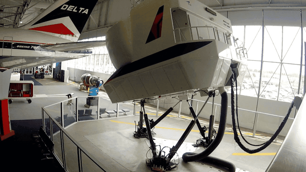

Human perception of acceleration has a big deadband. Flight simulators take advantage of that to give pilot trainees the illusion of unlimited motion even though the actual motion of the simulator is limited.
242023
