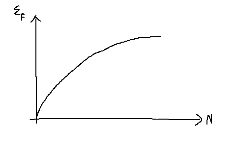

Part (a)
The Fermi Energy is the highest energy level occupied by the atoms at T = 0.
We know that ##\epsilon_f \propto \left( \frac{N}{V}\right)^{\frac{2}{3}}## so the graph looks like:
