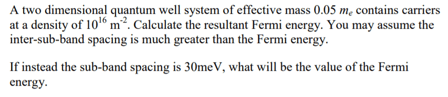

How to Determine Fermi Energy in a Quantum Well Without Given Temperature?
The discussion revolves around determining the Fermi energy in a quantum well, specifically in a quantum cascade laser, without a given temperature. The relevant equation for Fermi energy is provided as E_{F}=E_{i}+k_{B}Tln\left[exp\left(\frac{\pi\hbar^2n^{2D}}{k_{B}Tm^{*}} \right)-1\right], which inherently relies on temperature. Participants express difficulty in proceeding with calculations due to the absence of temperature data, highlighting the challenge of solving such problems in quantum mechanics.

2D density of states ##g\left(E \right)=\frac{m^{*}}{\pi\hbar^2}##
Fermi energy in a quantum cascade laser ##E_{F}=E_{i}+k_{B}Tln\left[exp\left(\frac{\pi\hbar^2n^{2D}}{k_{B}Tm^{*}} \right)-1\right]##
Problem Statement: See below
Relevant Equations: 2D density of states ##g\left(E \right)=\frac{m^{*}}{\pi\hbar^2}##
I've been stuck on this problem for a few days now, I really can't see how to proceed. I believe I have successfully completed the first part of the question but can't do the second part. I have found the equation for the Fermi energy in a quantum cascade laser but it depends on temperature and I am not given a temperature to work with. Any help would be really appreciated.
