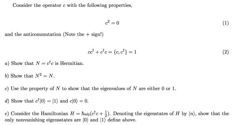

Given in question.
Hello
I'm having some difficulty with part e of this question. Not sure how to go about proving that. Would a possibility would be deriving the following equation:
##|n⟩= \frac{1}{\sqrt{n!}}(c^†)^n |0⟩ ## ?
You know that ##c^2 = 0##. So what can you say about ##\left(c^\dagger \right)^2 = \; ?##
Then think about ##[H, c^\dagger] = \; ?##, etc.

Thanks for the reply. Then ##\left(c^\dagger \right)^2 = 0##. However I'm not picking up on the reasoning for determining the commutator. If I remember correctly if two operators commute then they share the same eigenvalues, is that correct?

No, it's a bit more subtle. For example, for a free particle, the momentum ##\hat p## and Hamiltonian ##\hat H = \frac{\hat p^2}{2m}## commute, but the eigenvalues of ##\hat p## have units of momentum and the eigenvalues of ##\hat H## are energies. Clearly, they can't be the same values. Moreover, you can have eigenstates of the Hamiltonian which are not momentum eigenstates.
Yes.
However I'm not picking up on the reasoning for determining the commutator. [...]
You gave an equation for ##|n\rangle##. So what is ##|2\rangle, |3\rangle, \dots## ? From this what can you conclude about the structure of the Fock space?
Then evaluate ##H |0\rangle## and ##H |1\rangle## ...

Right, so ##|n\rangle = 0## when ##n=2,3,4...##, in which case the only non vanishing ones are when ##n=0,1## as required. And then evaluating ##H |0\rangle## and ##H |1\rangle## is straight forward using the relations given in part d and before.
Is your expression for ##\lvert n \rangle## justified? Does applying ##c^\dagger## repeatedly generate all possible states?
I think it would be better if you considered the fact that you can write N in terms of H. Then use what you showed in part (c).
