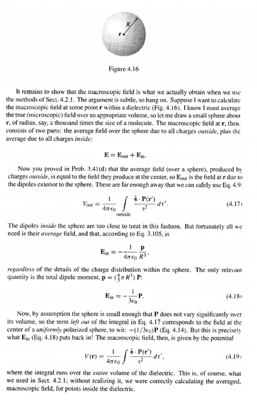

Hi guys, I do not really understand the explanation bit where he describes the "term left out" of the integration. Why is there any term left out? I thought it's rather straight forward that E = E(inside) + E(outside)?

If you don't give us the statement you have problem with,we can't help!

I find this traditional derivation also quite obscure.
If you look at a correct expression for the field of a dipole, e.g.
http://en.wikipedia.org/wiki/Dipole
under "Field of an electric dipole" you see that there is a second term proportional to one third of the dipole moment times a delta function, which is the only term which survives averaging and yields directly the average dipole moment density.
Griffiths's derivation looks pretty correct and straight-forward to me, although I hate it if derivations in a text rely on exercises to be solved by the reader. Of course, as an author this spares you to type a lot of details of a calculation ;-)).
Anyway, what he does is to separate the problem of averaging of the microscopic field over a macroscopically small but microscopically large region in a part "far" (i.e., far on a microscopic scale) from the point in question and one "near" (on a microscopic scale). So he was taking out a sphere of microscopically large but macroscopically small extent of the integral first. The remaining integral can be treated with the macrocopic field for the region outside of the sphere, and the remainder integral can be calculated exactly in terms of the charge distribution.
