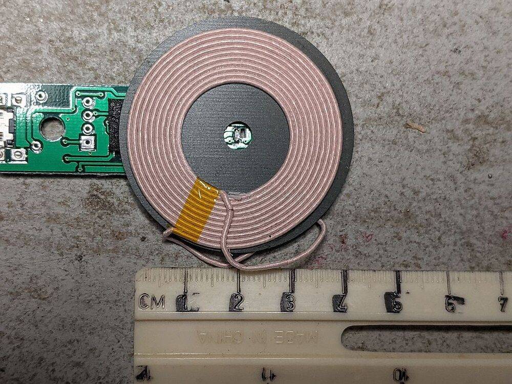

What is the magnetic field of a coil used in a QI charger?
Attached is a photo the the primary transformer coil of a QI (I believe pronounced CHEE) wireless charger, as used for charging a cell phone. I know the fields of solenoids but what would be the magnetic field structure of this. By-the-way, a similar coil was used on old AM radio sets.

The magbnetic field is in the form of a "doughnut". The same form as for a single wire loop.

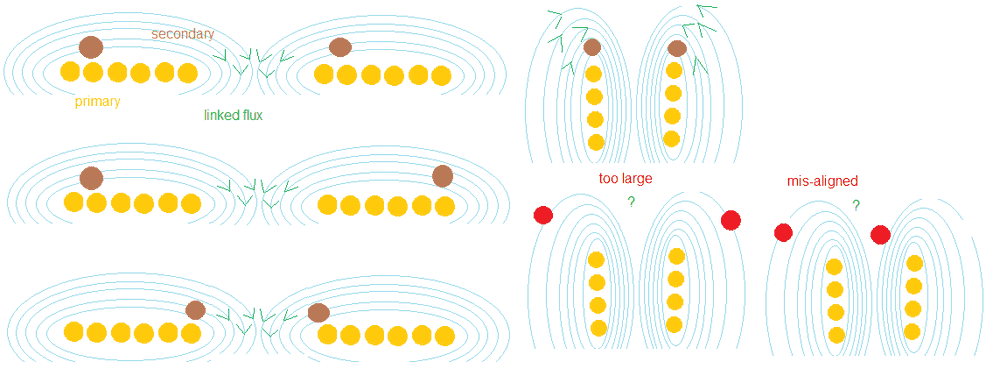

You can think of a pancake coil as having a flux similar to a very short solenoid.
Just as a solenoid can be modeled as one single turn of a cylindrical current sheet, a pancake coil can be modeled as a single turn of a flat current sheet.
The magnetic field between each pair of turns is cancelled, so for a pancake coil, the magnetic flux passes inside the inner turn and outside the outer turn.
I don't know about these. Would I be right in guessing that the pancake coil, apart from being flat and thus easier to fit, would also accommodate a range of secondary coil sizes and also be more tolerant of mis-alignment?

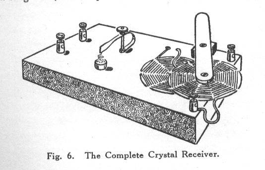

BTW I didn't know what you meant by this sort of coil in AM radios. They would be too low inductance for tuning the AM bands, IMO, though I had seen them used in ATU's for matching.
But I started in the 1950's. You are going back to the 1920's. I attach pics of a crystal set design. The text admits it has poor selectivity, as one would expect using a small inductance and the heavy damping of a crystal set.

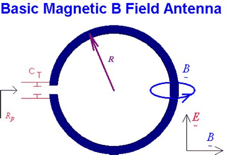

The magnetic field is in the form of a "doughnut". The same form as for a single wire loop.
Given a simplified analogy between a transformer coil and a loop antenna, the magnetic (B) field of a single loop of the coil becomes easier to visualize.
Loop antennae in various guises appeared in early radio sets particularly in direction finding rigs. As a point of departure, one can model solenoid magnetic fields by vertical stacking and the 'pancake coil' via concentric loops. Perhaps too basic for the topic of Qi chargers.

Yes, the flux passes through the hole in the centre, which is far from the outer flux path, so alignment is easy, and orientation is not important. The pancake is flat so the other coupled coil can be close and well coupled.
What is the black plane behind the pancake in post #1 picture ?

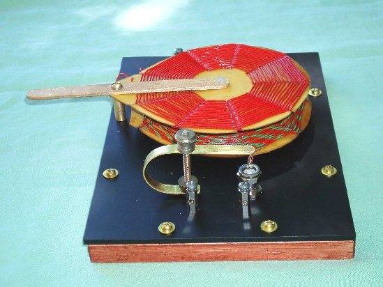

I recall seeing a few table-top vacuum tube radios with a pancake coil mounted on the inside of the back cover. They were wound with cotton covered wire, perhaps 24ga. If I recall correctly they had three leads, so were tapped.
Manufactured probably around the 1930's to '40's.
There is another coil very similar to a pancake coil. Early wireless receivers sometimes used a loop antenna or coil made in the form of a spiders-web. It was wound on an odd number of pins or slots which reduced inter-turn capacitance and AC resistance.
https://commons.wikimedia.org/wiki/File:Spider_coil.jpg
The coil could be tuned, but mostly it was used as a separate loop antenna that was connected to a tap or primary on the tuned RF front-end. Some loop antennas were hinged so they could be swung independently to peak a signal, or to reject an interfering station in a particular direction.
