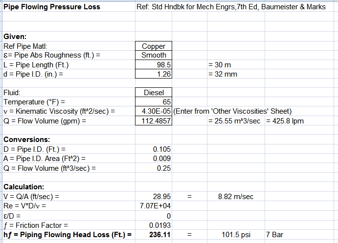

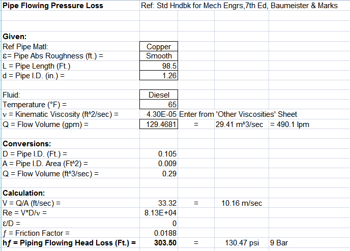

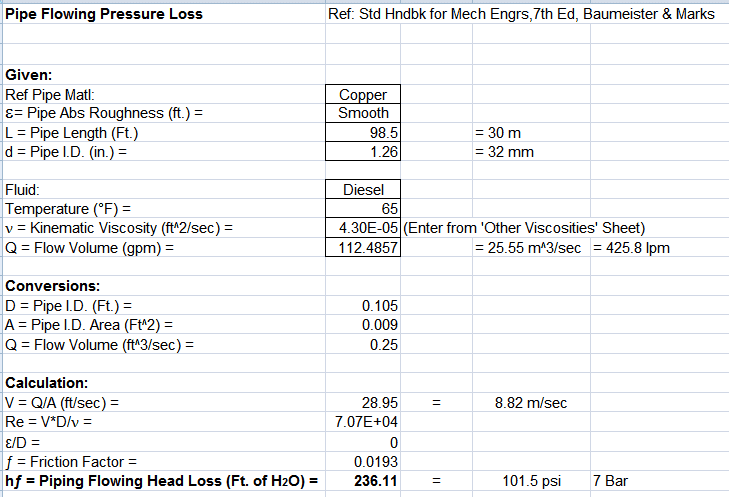

During the above calculation I wrongly remembered the pressure value for the recirculation valve opening as being 9 bar. Below is the corrected calculated flow rate for the 7 bar pump limit.
In addition to the above I have developed the attached MSExel graph of the hose ΔP vs Flow Rate from 100 to 900 lpm based upon your hose and fluid data if this will help give you the type of data you are seeking.
many thanks JBA, the max we can pump into a 32mm hose is 338lpm which is 7m/sec velocity, from your graph the ΔP @ 350 lpm is 5 bar. You are pretty close to the values the hose manufacturer provided us - ΔP 4.21 bar at 338 lpm for 32mm hose.
Is there a way to convert the ΔP to flow loss or slower flow rate? I am setting up the experiment here, will have actual final flow values soon.
The reason behind my question on the flow rate loss is, I just recalled a pump we worked on many years ago, its a 6 stage centrifugal pump with 350m head and 300 litres/sec at the pump discharge located near the river. The head and flow rate achieved at the mine about 150kms from the pumping station are 250m and 200 litres per second.
I am a bit confused about your question on flow loss from a given ΔP because you can use the graph in both directions to either find the ΔP for a given flow or the flow for a given ΔP.
If you want to determine the ΔP for flow rates below 100 lpm or above 900 lpm; or the flow rates for ΔP's less than .54 Bar or greater than 26.73 Bar, then I will need to run my program to add values in your desired range to the graph.
If you want to determine the loss for different hose lengths then you can simply use the ratio of the new length to 30 m and apply that to any given flow rate or pressure drop on the current graph. ie. for 90m of hose the ΔP for a given flow rate will be 3x the graph value for the 30 m hose length; or, the flow at a given ΔP will be 1/3 of the graph flow value for the 30 m hose length, etc.
Let me know if there is something other than those two modifications and if you will give me the flow or pressure drop ranges you would like to see added to the graph I can easily provide a graph with an expanded range including those new values.
