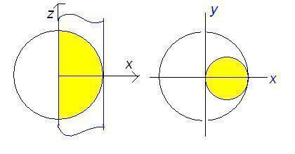

I drew the graph in my copybook. The sphere has radius a from the center (0,0)
The cylinder has center (a/2,0) and radius a/2
Then, i don't know what's the next step.

Think of an apple corer, used not through the centre of the apple.
You integrate for a domain is the x,y plane. How this domain looks like? What are the bounds for x and y?
ehild

You can project the thing on any plane. See the projections on the xz and xy planes in the attachment.
Think the apple corer is like your cylinder, its axis parallel to the z axis and imagine the piece of apple when you remove it from the cylinder of the corer.
ehild

OK, i think i understand. Your graph was very helpful. So, the surface area that i need to find is the surface area of the apple skin removed from the "piece of apple removed from the corer". That would mean the top surface (of the sphere) and bottom surface (of the sphere). Two pieces of skin. Correct?
In that case, what do i modify in my calculations from my previous reply above? I'm confused.
Yes, you need to determine the area of both pieces of skin.
But you can not ignore the cylinder from the boundary of the region.
ehild
