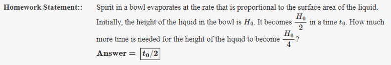

Spirit in a bowl evaporates at the rate that is proportional to the surface area of the liquid. Initially, the height of the liquid in the bowl is ##H_0##. It becomes ##\dfrac{H_0}{2}## in a time ##t_0##. How much more time is needed for the height of the liquid to become ##\dfrac{H_0}{4}##?
##\mathbf{\text{Answer =}}\;\; \boxed{\boldsymbol{t_0/2}}##
1. The area of the (circular) surface of radius ##R(t)## at an instant ##t##: ##A(t) = \pi R^2(t) ##
2. [I do not know how to connect the height ##H(t)## of the water surface to the radius : ##H(t) \stackrel{?}{=} R(t)##]
Three diagrams of a hemispherical bowl on a horizontal line, each with blue liquid: at Start the liquid fills to depth H0, after time t0 to depth H0/2, and after time t=? to depth H0/4.
Problem statement :
I draw the problem statement above. I hope I am correct in inferring that the bowl is hemispherical.
Attempt : I could not attempt to the solve the problem. We are given that the rate of change (decrease) in volume is proportional to the surface area : ##\dfrac{dV}{dt}\propto A##. The surface area ##A = \pi R^2##. The problem is, how to find an equation for the volume of the spirit as a function of radius ##R## and height ##H## : ##V \stackrel{?}{=} V(R,H)##.
A hint or suggestion would be most welcome.

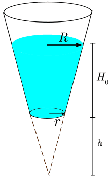

Diagram of an inverted cone-shaped vessel with its tip at the bottom, containing a cyan liquid up to height H0 below the rim; labels R (top radius), r (liquid surface radius) and h (height of the tip below the liquid).
##\mathbf{\huge{\checkmark}}##matching the answer.
Attempt (2) : (Second simplest) ##\text{A (conical) bucket}##
I draw an image for the problem. I do not want to show my calculations here, for there is plenty, but I will say that the rate of evaporation of the fluid, ##\frac{dV}{dt}=kA##, leads to the value of ##k## which is not a constant. It depends on the initial height ##H_0## as well as its (time) derivative ##\dot{H_0}##. Needless to say, I could not progress with my solution to where the volume first reduces to a half and then to a quarter.
I am willing to abandon this line of enquiry (I had a hemispherical bowl next in mind). I would be willing to try out the leads of both @Delta2 and @Chenkel above. I would be glad if you two could elaborate.

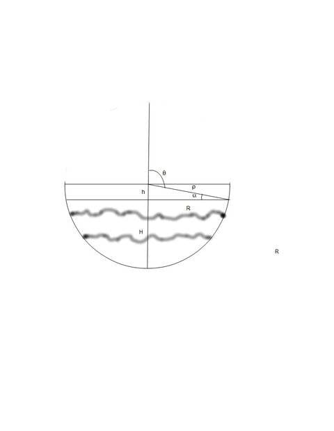

We seek the time dependence of the depth of a liquid in a hemispherical shell due to evaporation assuming the evaporation rate (change in volume w.r.t time) is proportional to the surface area and assuming constant pressure, temperature, humidity, and no wind. That is,
\frac{dV}{dt}=\gamma A
where ##V## is the volume,##\gamma## is the constant of proportionality, and ##A## is the surface area. We first compute the volume in terms of the depth of the liquid and construct the volume integral. From the diagram below,
Diagram of a hemispherical bowl of radius R with a vertical axis, a horizontal liquid surface cutting it, and a flat-topped dashed region; labels include H for depth, h, rho, theta and alpha, with R marked inside and outside the bowl.
From the diagram we see,
h=\rho - H
\alpha = \sin^{-1}(\frac{h}{\rho})= \sin^{-1}(1 -\frac{H}{\rho})\\
where ##H## is the liquid depth. The volume integral, in spherical coordinates, becomes
V=\int_0^{2\pi} \int_{\frac{\pi}{2}+\sin^{-1}(1 -\frac{H}{\rho})}^{\pi}\int_{\rho -H}^{\rho}\rho^{'2}\sin(\theta^{'})d\rho{'}d\theta^{'}d\phi^{'}
Evaluating the integral we find
V=\frac{2\pi}{3}\rho^{3}y^2(3 -3y +y^2)
y=\frac{H}{\rho}
We take the derivative of ##V## w.r.t time;
\frac{dV}{dt}=\frac{2\pi}{3}\rho^{3}y(6-9y+4y^2)\frac{dy}{dt}
The surface area is ##\pi R^2## with ##R^2=\rho^2-H^2## we have
\frac{dV}{dt}=\gamma \pi \rho^2 y(2-y)
\frac{2\pi \rho^3}{3}y(6-9y+4y^2)\frac{dy}{dt}=\gamma \pi \rho^2 y(2-y)
We integrate both sides of the equation
\frac{2\rho}{3\gamma}\int \frac{(6-9y+4y^2)}{(2-y)}dy=\int dt
These integrations evaluate to
-y^2+\frac{y}{2}-\log((y-2)^2)+C=\frac{3\gamma}{4\rho}t
where ##C## is the constant of integration. To determine ##C## we assume at time ##t=0##, ##y=1##, i.e. the hemisphere is filled to the brim. We find
C=\frac{1}{2}
To evaluate ##\gamma## take the measurement of depth (##H_0##) at time ##t_0##
-(\frac{H_0}{\rho})^2 + \frac{H_0}{\rho}+\frac{1}{2}-\log((\frac{H_0}{\rho}-2)^2)=\frac{3\gamma}{4\rho}t_0
and we find for the equation for normalized depth vs. time
-y^2 + y + \frac{1}{2}-\log((y-2)^2)=\frac{t}{t_0}(-(\frac{H_0}{\rho})^2 +\frac{H_0}{\rho}+\frac{1}{2}-\log((\frac{H_0}{\rho}-2)^2))
The equation of ##y## as a function of time can't be expressed in terms of elementary functions and must be evaluated by numerical techniques. I wrote a C++ routine to find ##y(t)## with accuracy ~one part in ##10^{-10}##. Taking ##\frac{H_0}{\rho}=\frac{1}{2}## and ##t_0=500## I obtained the following plot

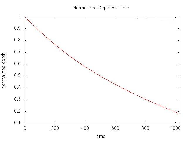

Line graph titled Normalized Depth vs. Time: normalized depth falls smoothly from 1 at time 0 to about 0.18 at time 1000, with a decreasing curve.
  • Skeptical
Anything that is not a straight line is wrong.
Is that a religious doctrine or do you have mathematical proof of your assertion?

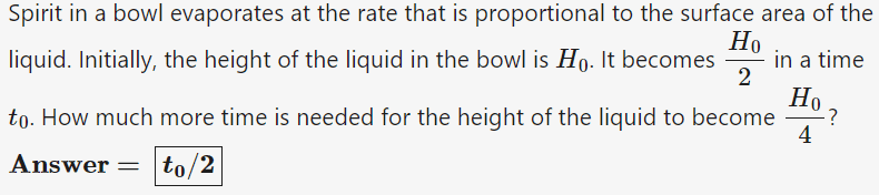

Text reading: Therefore, since it is given that dV/dt = kA and we have dV/dt = A dh/dt, we can say that dh/dt = k. So it means that if the volume decreases (or increases) with time proportional to the surface area, the rate of decrease (or increase) of the height of the liquid is a constant?
Yes indeed the height decreases at a constant rate : ##\dfrac{dh}{dt}= k##.
Now, according to the problem, the height becomes ##\dfrac{H_0}{2}## in a time ##t_0##. Hence, it will reduce by a (further) amount of ##\dfrac{H_0}{4}## in half the time as above, that is ##\boxed{\dfrac{t_0}{2}}##.

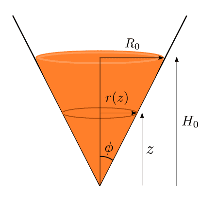

Insight : I think the crucial insight from the problem is that an incremental volume of a shape can be written as ##dV=A dh##. This is true for all shapes, as all shapes are infinitesimally "regular" - i.e. prismatic, when the heights are vanishingly small.
If one is uncomfortable with the arguments above, one can always start from the volume element ##dV = dx\, dy\, dz##. Integrating over the full volume of fluid gives the total volume
V = \iiint dV = \iiint dx\, dy\, dz.
For a fixed ##z##, the cross sectional area ##A(z)## is given by integrating ##dx\, dy## over the cross section
A(z_0) = \iint_{z = z_0} dx\, dy.
By performing the ##x## and ##y## integrals in the volume integral first, we therefore obtain
V = \int A(z) dz
as expected.
