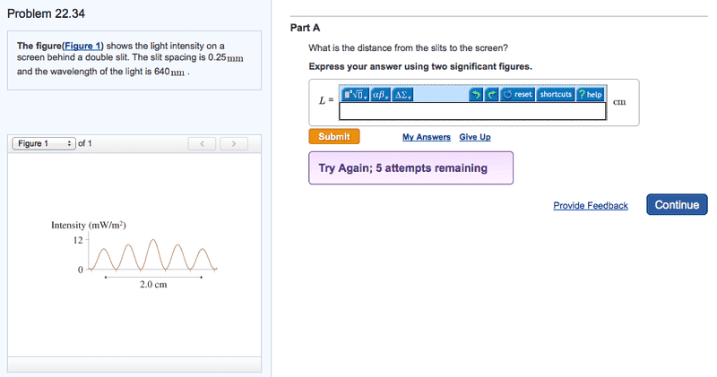

See attached image
y=L*tan(theta)
m*(lambda)=d*sin(theta)
Lambda = 640 nm = 6.4x10^-4 mm
1*(6.4x10^-4 mm) = (0.25 mm)*sin(theta)
theta = 0.15 degrees
y = L*tan(theta)
This is where I am not sure. I know I need to plug in y and theta. But I think my y value is wrong. How can I know for sure what the distance between the maxima are? The graph that is given seems to be too poor to tell.
  • Graph of light intensity in mW/m² against position on a screen, showing a wave-like pattern of equally spaced peaks between 0 and 12, with a horizontal span labelled 2.0 cm.
The diagram seems clear enough to me. Hint: The distance of 2.0 cm seems to be exactly between which two maxima? (Don't think you need to use m = 1.)
