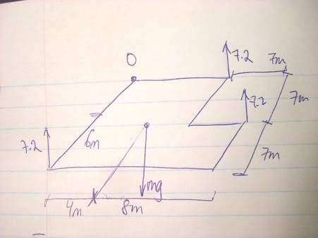

Each of the three cables can safely carry a maximum tension force of 7.2kN. Based on this criterion, what is the largest safe mass of the suspended ceiling?
Sum of forces=0
Sum of moments=0
I drew this for the FBD:
I then tried to solve this by just summing all forces in the y-direction to get 'mg':
7.2kN*3-mg=0
m=2201.83kg, which isn't right.
So then I tried doing it by finding the moment about some arbitrary point (O):
[tex]\sum[/tex]M0=-14*7.2i+5*7.2k+12*7.2k-7.2*7i-4Wk+8Wi=0
From which:
-14(7.2)-7.2(7)+8W=0 W=18.9kN
and from 5*7.2+12*7.2+4W=0 W=30.6
So those don't even give me the same value... What am I doing wrong? Wrong assumption about all tensions being 7.2kN?
Yup! :biggrin:
The tensions will be different … the suspended ceiling will stay safe only if the greatest tension is ≤ 7.2kN :wink:

Well, actually I figured it out. You've got to determine which cable has the greatest tension (I picked a random value of mg and calculated all tensions), which happens to be A. Then you express A in terms of W and that's how you figure out the mg, thus m.
