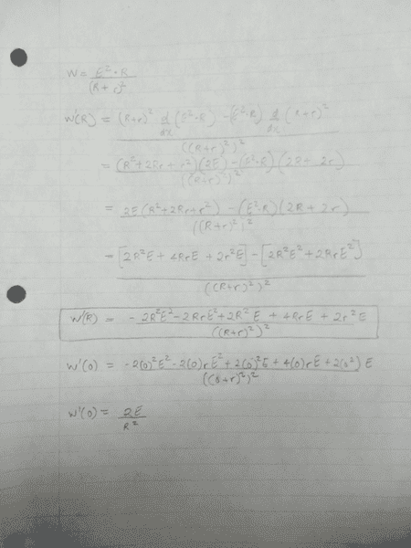

Okay, I have done some work. I found the derivative of W'(R) and set it to 0. Here is what I got
You're not interested in dW/dx, whatever x is. You want to calculate dW/dR and set that equal to zero, not set R = 0. You also want to show that W is a maximum when r = R.
BTW, if you express W as the product of two expressions, rather than the quotient, you can save yourself some calculation when finding the derivative.

So I derived for dW/DR and this is what I got
If I set R = 0
I would just get 0.

Here's what I said earlier, in post #2.
Mark44 said:
Solving for R won't help you. To find the maximum value of a function of a single variable (R here, since r and E are assumed to be constants), find the derivative W'(R) and set it to zero.
I didn't say anything about setting R to zero -- I said you should set W'(R) to zero.
Which is incorrect, BTW.
If I set R = 0
I would just get 0.
And Mark44 is right. You don't set R = 0, you set dW/dR = 0, which is different. But you must calculate the correct expression for dW/dR.

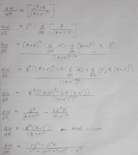

So I found the expression for dW/dR
After the deravation, if I set dW/dR to 0, and set r and E to 1, I get a L shape graph. The x and y basically start from origin and y is + and x is positive

Please post your work as text rather than as an image. Posting an image makes it impossible for us to insert a comment at the point of a mistake. Instead, we have to give the location where you are in error, which makes more work for us.
There is no need to set r and E to any particular values.
"Keep your eye on the prize." -- the goal here is to show that W is at its largest when R = r.

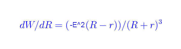

What you ended with is correct, but it can be written in a slightly more simplified form:
##\frac{dW}{dR} = \frac{E^2(r - R)}{(R + r)^3}##
What does it take for a fraction to be zero? There is absolutely nothing to gain by expanding ##(R + r)^3##.
The first line of your work contains an error.
W = E2*R/(R+r)2 not dW/dR = E2*R/(R+r)2
You would run into less algebra if you wrote
W = E2*R * (R+r)-2
and then used the Product Rule to find dW/dR
