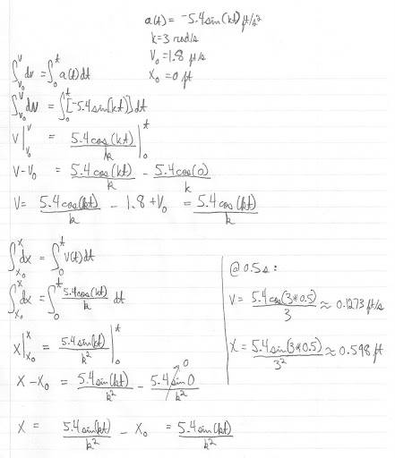

Okay, I have the answers now, but why are we not adding a constant of integration when integrating up from acceleration to velocity to position? Like a v0 and x0 term?

So I got the answers which kind of makes me happy, but why doesn't the v(t) equation have a v0 term (constant of integration)? Likewise, why doesn't the x(t) equation have something like v0t + x0
By the way, thanks for your help... And I appreciate you not just giving me the answers flat-out... Can't learn that way!

You add a constant of integration when you do math not physics. In physics there are always limits of integration that take into account the needed constants. More formally, you start from dv = a(t)dt and integrate with limits of integration as shown below
[tex]\int^{v}_{v_0}dv=\int^{t}_{0}a(t)dt[/tex]
Note that this describes physical reality and says that "at t = 0 the velocity is v0 and at t = t, it is v" which basically establishes v(t) and takes into account v(0). Do it formally this way and see what you get.

Your explanation was fantastic. Here is what I've got.
Handwritten derivation of velocity and position from a(t) = -5.4 sin(kt) with k = 3 rad/s, v0 = 1.8 m/s and x0 = 0, integrating to v = 5.4 cos(kt)/k + 1.8 and x = 5.4 sin(kt)/k^2 - x0, with values at t = 0.5 s.

Great. Now you are ready to understand the "constant of proportionality." Note that
a(t) = -5.4 sin(kt)
x(t) = (5.4/k2) sin(kt)
In other words, x(t) = -(1/ k2) a(t), which says that the position at any time t is proportional to the acceleration at any time t. That's what I had in mind when I posted my first response to your question.

Ok, so in this example, the constant of proportionality states a relationship between position and acceleration. Knowing that x(t) is -1/k2a(t), I can just find the acceleration at any point in time and multiply it by -1/k2 to find the position at that time. Neat.
And once you know x(t), you take its time derivative to find v(t). It's a shortcut.
