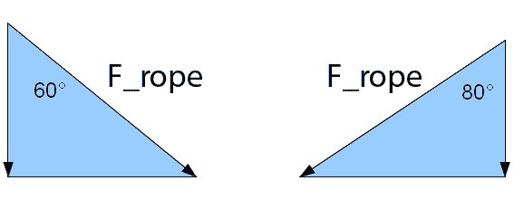

A mountain climber, in the process of crossing between two cliffs by a rope, pauses to rest. She weighs 695 N. As the drawing shows, (The angle at left is 65) she is closer to the left cliff than to the right cliff (Angle to the right is 80), with the result that the tensions in the left and right sides of the rope are not the same. Find the tensions in the rope to the left and to the right of the mountain climber.
I tried Wsin65+WSin80+W=0 and worked my way out from there, it came out wrong.
Hmmm...i attached the image. I hope you can see it, & help me if its possible.
  • Diagram of a climber suspended by a rope strung between two cliff edges, with the rope making an angle of 65.0° with the horizontal on the left and 80.0° on the right, with dashed vertical lines marking the supports.
I've drawn you a picture. Try now.
Two blue shaded right triangles with arrows along their sides, each labelled F_rope with an angle of 60° and 80° respectively, showing rope force vectors.
Note that i just named them the same, but F_rope is different for each rope.
  • Two blue right-triangle force diagrams, each with a downward arrow and a rope force arrow labelled F_rope; left triangle angle 60°, right triangle angle 80°.
