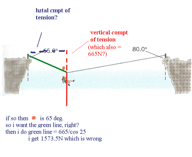

A mountain climber, in the process of crossing between two cliffs by a rope, pauses to rest. She weighs 665 N. As the drawing shows, she is closer to the left cliff than to the right cliff, with the result that the tensions in the left and right sides of the rope are not the same. Find the tensions in the rope to the left and to the right of the mountain climber.
IN THE PICTURE: there is a mountain climber suspended in the air almost halfway between 2 cliffs. It gives me two of the angles (the angle btwn the rope and the posts it is tied to on either end). One angle is 65 deg, the other angle on the opposite cliff is 80 deg.
So far, I drew 2 separate triangles. I made the y-axis of one of the triangles the 665N, and used trig to find the "length" or "tension" of the rope, but it keeps coming up to be incorrect. I know I am doing the trig right (I'm really great at trig and have taken through calc II so the math isn't the problem).
Any suggestions? This thing is due tonight and we have our midterm exam on Wednesday. Thanks!
This should be nothing more than simple resolving of forces. If you can post any working perhaps that would help in a diagnosis of where you have gone wrong.

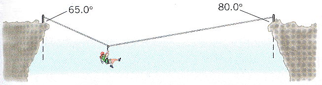

This is the original picture:

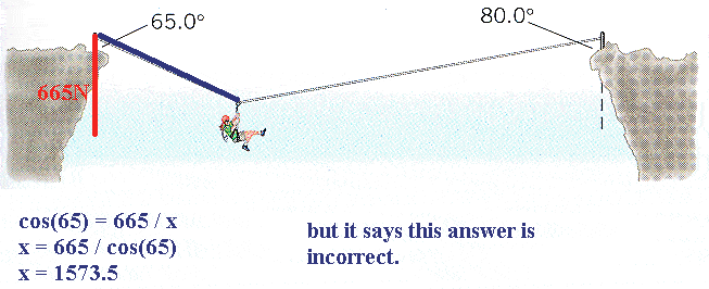

And here is what I did (at least for the first part of the question; it wants 2 different answers -quite obviously- for the 2 different tensions).
The weight is the weight of the person, not the pole! The correct approach to this question is to consider the forces acting on the person. Resolve the tensions into horizontal and vertical components, then consider the resultant forces on the person in the horizontal and vertical directions.

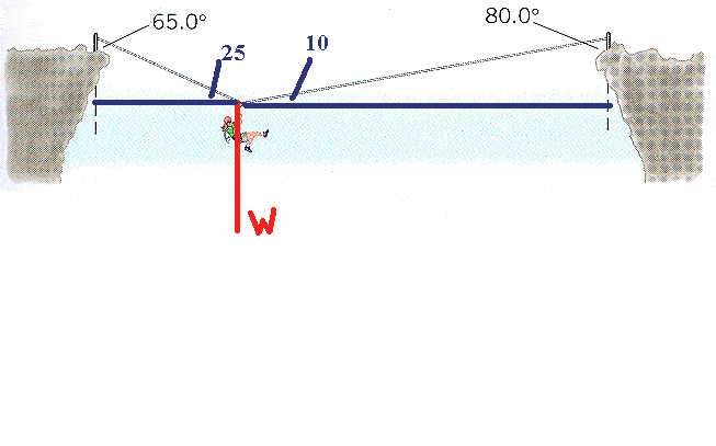

I don't quite understand that. But here's what I've done.

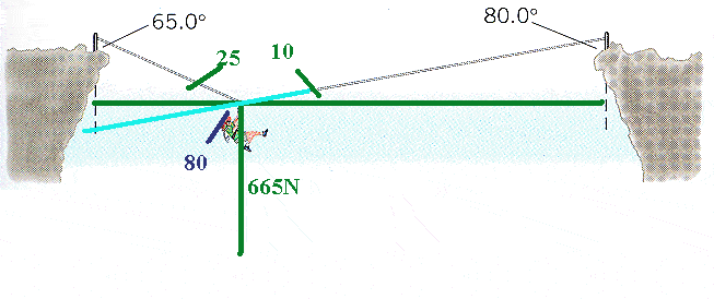

and then

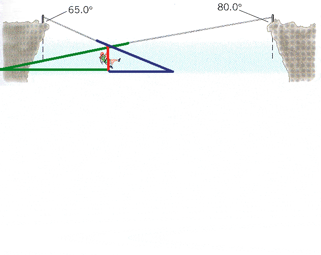

I've tried this (enter in correct angle markings)... basically what I described. have any guidance for me?

I think cristo hinted it out very good for you. Isolate the joint where the climber is hanging from. In the vertical direction her weight acts down, and the vertical componens of tension forces act up. Think Newton. In the horizontal direction, look at the horizontal components of the tensions, and what does Newton say about their sum??

There are Two Tensions, one for each rope. Each tension has a horizontal AND a vertical component.

In your summation equation in the vertical direction, there are 2 vert components of the tension forces, T1 and T2. Their vertical components sum to 665. Now look in the x direction for another equation using the hoizontal components of the 2 tension forces.
And yourn going to end up with two equations. Sum of the forces in the X direction, and sum of the forces in the Y direction, with two unknowns, you'll be able to solve.
