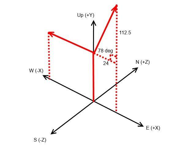

OH! So since the V2x' is positive, it means that it is going east, and since the y is positive as well (it is north) I can then say it is 78 deg N of E?

Correct. If it only splits into two parts and one goes exactly west the other must have a component that is exactly east. That way momentum in the Z axis is conserved.
No that's not correct. Y was the vertical axis. So your 78 degrees is the angle it makes with the horizontal. I have made a diagram. Everything happens in the XY plane..

Ah okay, that makes sense now. But the angle can still be 78 degrees N of E as that implies it is north of the horizontal right?

No "North of east" would mean it had a component in the Z axis. It must go exactly east and upwards.

ahh okay.
Makes great sense now. Thank you!
