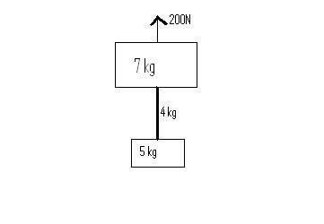

two blocks of masses 5kg and 7kg are connected by uniform rope of mass 4kg.an upward force Force=200N is applied on the system .How to find the tension at top, lower and midpoint of the rope
(take g=10m/second square).I only know this.Please tell me the formula to calculate the tension at top,lower and midpoint of the rope.
You've got a start on your force diagram. It looks good as far as you've gone. Finish it. First hint: F = ma.
As Bystander writes, you need to show all the forces in the diagram. However, I would suggest you do this with separate free body diagrams for each part on which a force of interest acts directly. How many such components are there?
By the way, please use thread titles which give some guidance as to the topic. It will help you get timely answers.
The trick is to realize that everything must accelerate at the same rate because they are tied together.
