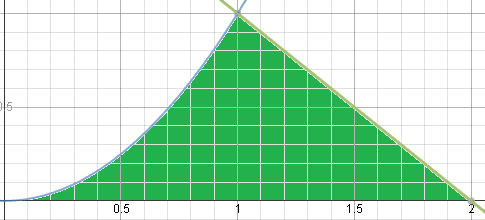

Find the area beween the curves $y=x^2$ and $x+y=2$ and the x axis
First on graphing these the $x-axis$ seem irrelevant in that it is outside the area to find.

I am thinking, given the original problem statement, that you are to find the following area:
For the interval $0\le x\le2$ I get $-\frac{2}{3}$
Did you set it up as:
$$A=\int_0^1 x^2\,dx+\int_1^2 2-x\,dx$$ ?
No that would be 2/3
I get a different result, but I can't tell where you and I differ without seeing your work...:D
Yes, you are correct Mark. Sorry for misreading the question karush. I was thinking of this region in light green but Mark is correct. :)
