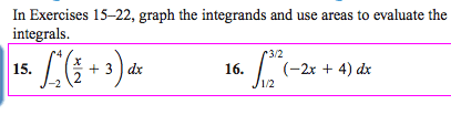

Textbook exercise header 'In Exercises 15-22, graph the integrands and use areas to evaluate the integrals.' followed by integral 15: integral from -2 to 4 of (x/2 + 3) dx, and integral 16: integral from 1/2 to 3/2 of (-2x + 4) dx.

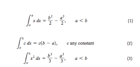

Three integral formulas with their results: integral from a to b of x dx = b^2/2 - a^2/2 for a < b (1); integral from a to b of c dx = c(b - a), c any constant (2); integral from a to b of x^2 dx = b^3/3 - a^3/3 for a < b (3).
I don't see why you have to put the ((x/2)+ 3)dx next to the equation for a trapezoid. I also don't understand what number would equal x, 4? 2?. Also, the dx, what equation am I supposed to be deriving? .5((B+b)/2)h? that equation doesn't derive.
The left edge of the trapezoid goes from (-2, 2), on the left, to (4, 5), on the right. Since it is a line, its equation is of the form y= ax+ b. Setting x= -2, y= 2, that gives the equation 2= a(-2)+ b or -2a+ b= 2. Setting x= 4, y= 5, that gives 5= a(4)+ b or 4a+ b=5, two equations to solve for b. Subtracting the first equation from the second, (4a-(-2a))+ (b- b)= 5- 2 or 6a= 3 so a= 3/6= 1/2. Putting this into 4a+ b= 5 gives 2+ b= 5 so b= 3. That is, the equation of the top line is y= (1/2)x+ 3 which is the same as the f(x)=(x/2)+ 3 shown in the picture.
Now, imagine drawing a thin rectangle from the base, y= 0 to the top line y= f(x)= (x/2)+ 3. It height is just the y value minus 0, (x/2)+ 3. We can think of the base as being the very small number [itex]\delta x[/itex]. The area of that rectangle, height times base, is [itex]((x/2)+ 3)\Delta x[/itex] and, since we can cover the trapezoid by such rectangles, we can approximate the area by [itex]\sum ((x/2)+ 3)\Delta x[/itex]. That's what is called a "Riemann sum". We can take the limit as the bases get smaller and smaller, converting that Riemann sum to the integral [itex]\int ((1/2)x+ 3)dx[/itex]. Of course, x ranges from -2 on the left to 4 on the right so the integral is [itex]\int_{-2}^4 ((1/2)x+ 3)dx[/itex].
If F'(x)= f, that is, if f is the derivative of F (F is the anti-derivative of f) then [itex]\int_a^b f(x)dx= F(b)- F(a). You evaluate the anti-derivative at the lower and upper values, -2 and 4 in this problem and subtract.[/itex]
I found this technique over at the Khan Academy
1. find the antiderivative
2. subtract the value of the B antiderivative from the A antiderivative
