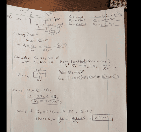

Find the capacitance of C3 and its charge

From the textbook:
/ 3. The Attempt at a Solution
My attempt at the solution: looking to fix my issues and help correcting my work.[/B]
You have used incorrect formula for voltage across capacitor.
You need to write the voltage across capacitor in terms of charge and capacitance.

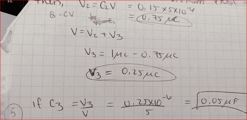

Should be V=Q/C?
Kelsi_Jade said:
Should be V=Q/C?
Yes.
So, would this be accurate?
I think that's right for (a). Much better than before. :approve:
For (b) you don't actually need the answer to (a). You might be able to say it off back of head. :oldwink:
After which calculation of (a) is a bit simpler.
