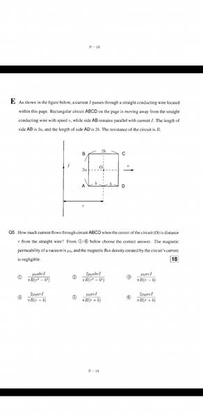

there is circuit ABCD shaped as a square next to a wire
circuit description :
with AB (vertical) = 2a
BC (horizontal) = 2b
the center is O.
O to B is b ( B to C = 2b)
what is the current flow in ABCD circuit, when the circuit reached r away from wire to its center O?
(the circuit move with speed v to right, AB still parallel to wire)
the question says B (Magnetic flux density) to be negligible
You should distinguish the ##I## in the long wire from the currrent in the ABCD loop. Still can't read the picture...[edit] better now...
And you need a relevant equation for V, the emf induced in the loop
V = emf = electromotive force = L.B.v
emf = L. ##\frac{µ0 * I}{2 \pi r}##.v
emf = 2a. v. ##\frac{µ0 * I}{2 \pi (r - b)}##​
I ind = Emf/R = av ## \frac{µ0 * I}{\pi R (r - b)}##
And where is that emf ? In AB, BC, CD or DA ?
it is on AB
What about the others ?
Can you please elaborate? Because i don't understand
You found an emf on AB. Does any of the other sides of the square also have an emf ?

Emf BC = bv##\frac{µ0.I}{\pi (R-b)}##
Emf CD = av##\frac{µ0.I}{\pi (R+b)}##
Emf AD = bv##\frac{µ0.I}{\pi (R-b)}##
No sir. Only one out of three is (almost :rolleyes:) correct :biggrin:.
You want to look carefully at the here link in #20.
And in fact, also at the keep going one...
The only one right is CD and the answer is B? But i don't understand why. Why there is no voltage in BC and AD?
BC and DA, that is. They correspond to the middle picture where no emf is induced along the wire.
You're very quick to pick the B answer and not A, but I suppose you worked it out properly ?
(did you understand my 'almost' in #22 ?)

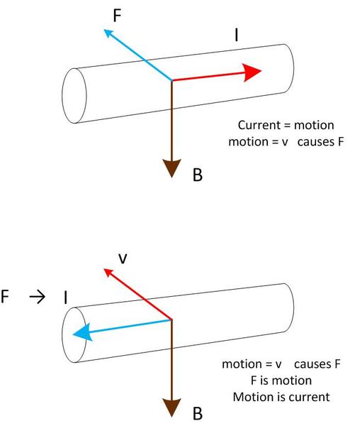

The way I remember things: I just start with the Lorentz force
BvU said:
To keep a long story short I add over a Thousand words:View attachment 168089
Big picture, big importance (imho)
Both pictures:
  • Positive ##x## direction is to the right
  • Magnetic field is down. Consider that the positive ##y## direction :smile:
  • Big arrowheads: in the ##x\, y## plane
  • Smaller arrowheads in the ##\hat z = \hat x \times \hat y## direction (a very simple cross product)
  • The coordinate system is right-handed
  • The Lorentz force is ##\vec F = q\, \left (\vec E + \vec v \times \vec B \right )##
  • There is no E field
  • Right hand rule: in ##\vec a \times \vec b = \vec c##
    a thumb
    b index
    c middle -- points in the direction of c​
  • Corkscrew rule: in ##\vec a \times \vec b = \vec c##
    turn ##\vec a## over the smallest angle towards ##\vec b## : Corkscrew goes in the direction of c​
Top picture:
  • We see a wire carrying current to the right. Current is moving charge. Moving charge has a "velocity".
  • We consider mobile positive charges in the wire :smile:
  • The Lorentz force is ##\vec F = q\, \vec v \times \vec B ##
  • All moving positive charges in the wire feel this Lorentz force
  • Together they "push" in the direction of ##\vec v \times \vec B ##
  • mutatis mutandis for moving negative charges: they move in the negative x-direction and the resulting Lorentz force points in exactly the same direction (- q x -v = +q x +v)
Bottom picture:
  • We see a wire being dragged in the positive ##z## direction with a velocity ##\vec v##.
  • Together they "push" in the direction of ##\vec v \times \vec B ##, which is the negative ##x## direction
  • This "push" is an electromagnetic potential (emf) that can cause a current.
Such a new thing for me to know.. thank you so much. So, the velocity direction is opposed to force?
Why only positive charges feel Lorenzt force?
Is the moving of charges produce Lorentz force or the positive charges moves to fight Lorentz force?
No. Velocity ##\vec v## and magnetic field ##\vec B##, are both perpendicular to the resulting force ##F##.
Helly123 said:
Why only positive charges feel Lorentz force?
Not what I meant. What I meant is: one doesn't want to confuse oneself unnecessarily by looking at negatively charged moving charge carriers. So if a current ##\vec I## is given, work with positive charge carriers moving in that direction.
The Lorentz force ##\ \vec F = q(\vec E + \vec v\times \vec B)\ ## works on ALL charges, negative (q<0) or positive (q>0)
(:smile: also on neutral charges (q=0) )
Motion of charge produces a magnetic field.
Positive charges move under the influence of a Lorentz force -- if they can. In a conductor (a wire), the positive charge carriers generally are not free to move. Electrons, the negative charge carriers, can move and thereby generate an emf.
I think I understand what you are trying to say here (correct me if I miss): Lorentz force on CD pushes electrons down and positive ions up. Positive ions can't move, electrons can. They don't move without limits (they don't pile up because they repel each other, and there is a resistance)​
