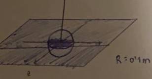

b)
[tex]\phi =\dfrac{Q_{enc}}{\varepsilon_0}=\dfrac{\pi \cdot R^2\sigma}{\varepsilon_0}=\dfrac{\pi \cdot 0'1^2\cdot 3\cdot 10^{-9}}{8'85\cdot 10^{-12}}=\boxed{10'65\, \textrm{Nm}^2/\textrm{C}}[/tex]

In section (b) I have applied Gauss law since I could calculate the internal charge of the spherical surface.

b) View attachment 262685
