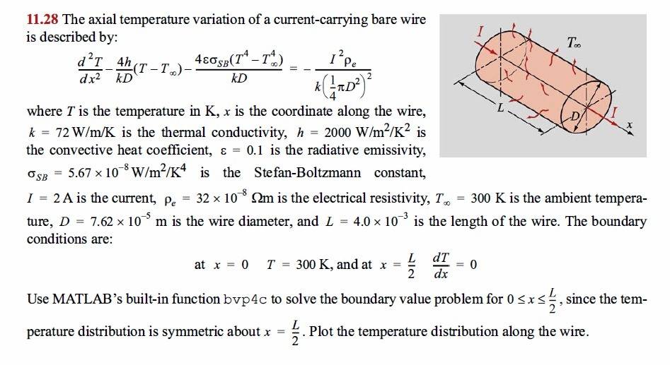

the temperature distribution of a current carrying wire using Matlab using the shooting method ?
in the figure .
hi guys
i was trying to solve this non linear ode using the shooting algorithm in Matlab :
Diagram of a bare cylindrical wire carrying current I in the x direction, with length L, diameter D, ambient temperature T∞, and red arrows showing heat loss from the surface.
i am not sure how to solve it using the normal shooting algorithm i have , since no other boundary at x = L/2 was given to check the shooting ?!
