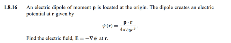

Find electric field due to dipole at any point using ##\vec E=-\nabla \phi##.
Question :
I have tried to solve but I struggle with this part:
Any help would be appreciated.
