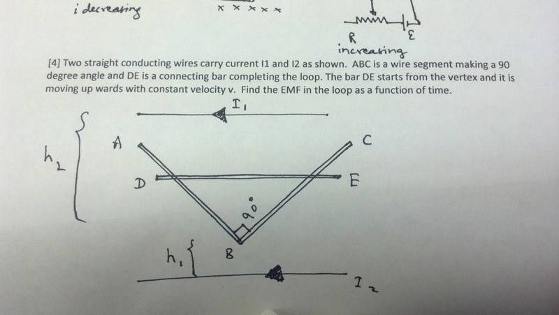

Find the EMF in the loop as a function of time.

I know that t is the variable and h1 and h2 I and I2 are considered given all we are doing is doing the algebra set up but not sure how to show this exactly.?

Recall the definition of the induced emf,
\text{emf} = - \frac{d\Phi}{dt},
where the magnetic flux is defined as
\Phi = \int \vec{B} \cdot d\vec{A}.
Your goal is to find the flux as a function of time (clearly it is a function of time, since the area of the loop is growing with time), and then insert that into the formula for the induced emf. So it's a two step process: evaluate the integral to obtain the flux, and then take its time derivative.
