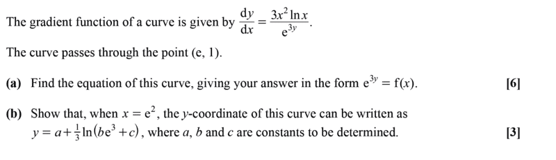

See attached
Integration
For part (a);
$$\int e^{3y} \,dy=\int 3x^2\ln x \,dx$$$$\frac{e^{3y}}{3}=x^3\ln x-\frac{x^3}{3}+k$$$$\frac{e^{3}}{3}=e^3-\frac{e^3}{3}+k$$$$\frac{e^{3y}}{3}=x^3\ln x-\frac{x^3}{3}-\frac{e^3}{3}$$$$e^{3y}=3x^3 \ln x-x^3-e^3$$
You may check my working...i do not have the solution.

You can check this for yourself, something you should always do when you solve differential equations. Since this is an initial value problem, checking your solution amounts to doing two things:
  1. Verify that the point (e, 1) satisfies the equation ##e^{3y}=3x^3 \ln x-x^3-e^3 ##.
  2. Verify that for the implicit equation you found satisfies the DE ##\frac{dy}{dx} = \frac{3x^2 \ln(x)}{e^{3y}}##.
I find your work correct. Only thing you could add more detailed steps is in the passage from first to second line, but yes ok it is just one integration by parts.

Thanks @Mark44 ...1. ##e^3=3e^3-e^3-e^3## (thus satisfied).
2.
##3e^{3y}y'=9x^2\ln x +3x^2-3x^2##
##⇒3e^{3y}y'=9x^2\ln x##
##y'=\dfrac{9x^2\ln x}{3e^{3y}}=\dfrac{3x^2\ln x}{e^{3y}}##
