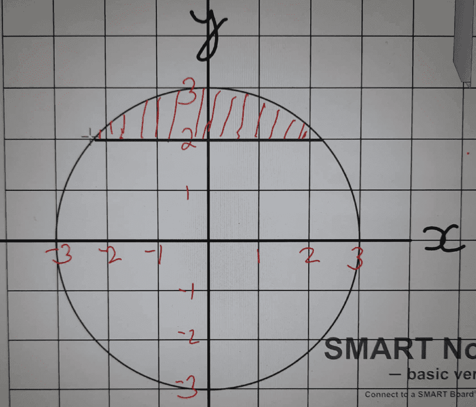

Sketch the region that satisfies the inequalities ##|z|≤3## and ##Im z≥2##
hence find the greatest value of arg ##z## for points in this region in radians.
complex numbers
since ##|z|≤3## →##z=0+0i##, therefore we shall have centre##(0,0)## and radius ##3##,
find my sketch below,
Hand-drawn Argand diagram: a circle of radius 3 centred at the origin, with the x and y axes labelled and tick marks from -3 to 3, and the region above the horizontal chord at y = 2 shaded in red hatching.
first let me ask is the shading of the region correct?
The sketch is good. So now, which point in the shaded region has the greatest argument? Determine the angle by drawing a triangle.

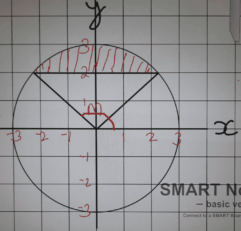

will the angle ##m## give us the greatest argument, i think i have to make use of two congruent right angles...right?
It'd be easier to just find the angle in the triangle you drew on the left, and then add ##\pi/2##. Anyway, you know the hypotenuse (radius) and the vertical side, so you should be good to go.

the radius would be ##3## what of the vertical side...why can't i see it aaargh??:smile:...or by accurate drawing, i should be able to get the values...
It's 2, right? It coincides with your line ##Im(z) = 2##!
bingo boss:cool:
  • Love
Just checking on this,
the least argument (in degrees) = $$tan ∅ = \frac {2}{2.23}=41.88^0$$
and largest argument (in degrees)= $$cos ∅ =\frac {2}{3}=48.19^0+90^0 = 138.19^0$$
A nice check here is if it was ##Im(z)=3/\sqrt{2}\approx 2.12##, then the argument would be 135 degrees. Since it's a little smaller than that, you have to rotate down the circle towards the x axis, and expect to get a slightly larger number.
I am not getting what you are saying, to find argument, we move in an anticlockwise manner from the start point ##(0,0)##...and my reference is on the second quadrant where have a right angle and i considered the sides, ##3,2## and ##\sqrt 5## to find the acute angle...I thought ##Im Z≥2##aaaaaaaaargh thanks Office...i now get your view. You were giving me a quick way of checking...happy new year mate:cool::cool:

I think your answer is right, I'm just describing a way you can double check that you got at least close to the right answer (for the largest argument)
