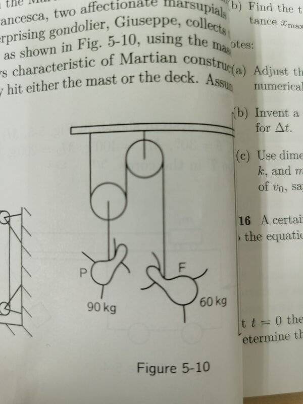

None of the identical gondolas can support both the loads of P and F. Giuseppe rigs them up from the mass as shown in the diagram, using massless ropes and massless, frictionless pulleys. He ferries them across before they hit either the mast or the deck. Assuming P's mass is 90kg and F's mass is 60kg, how much load W does Giuseppe save?
Hint: Remember that the tension in a massless cord that passes over a massless, frictionless pulley is the same on both sides of the pulley.
There are 3 different strings in this system. The one pulling P, the one pulling F and the one pulling a pulley. Since the questions says they're ferried across before hitting mast or deck, I'm assuming that they are not stationary.
g is gravitational acceleration.
P will move twice as fast as F, so ap = 2 af
60af = T- 60g
Tension on the string pulling the pulley and the string pulling P are both 2T
90ap = 90g - 2T
T=60(af+g)
T=45(g - ap)
150af = -15g
af = - 0.1g
T= 54g
Load = 3T = 162g
From this it doesn't look like any load was saved at all. The answer indicates a load saved of 2.7g.
How do you arrive at that?
The reliable way to work these things out, as in the earlier thread, is to look at how movements affect the lengths of string sections and note that the whole string has constant length.

I arrived at that from looking at how it moves. F go up by 1 unit, it will run down the pulley and go up again resulting in P lowered by 2 units.
As for 60+45 I had substituted the a.
As I wrote, the reliable way is to add up the lengths. Try it.

As for adding lengths I don't find it as straight forward. The right vertical decrease by Δx, the left vertical increase by Δx, the missing Δx I can't see it.
You are not finding your current method straightforward, since it is giving the wrong answer.
There are three straight sections, all vertical.
Working from the left, call them L1, L2 and L3.
If the total length is L, what two equations can you write that relate them?

ΔL1 + ΔL2 + ΔL3 = 0?

Yes, the sum of the lengths is constant, but there is an even simpler equation relating the first two. Just look at the diagram.

I don't think I can see it in terms of length. L3 contracts by Δx, L1 contracts by Δx, L2 extends by 2Δx?

Ignore L3 for the moment. If the left hand pulley rises by Δx, what happens to L1 and L2?
If the left pulley rises by Δx, both L1 and L2 will decrease by Δx.
So what equation does the give you relating ΔL1 and ΔL2?
ΔL1 = ΔL2, so in that case ΔL3 = 2 Δx?
Yes, assuming you are taking the change in the other two as -Δx.

I was able to solve it with this change. That said I still feel a little iffy about this method. I'll have to read up more on this.
