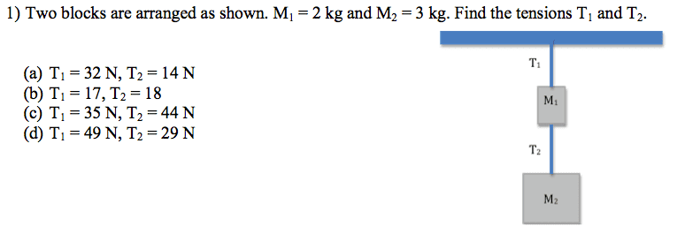

Find the tension T of the two blocks. I think I'm doing something wrong

Find the tension T of the two blocks. I think I'm doing something wrong :(
T1 = m1g = (2)(9.81) = 19.62
T2final = T2 + T1 = m2g + m2g = (3)(9.81) + (2)(9.81) = 29.43 + 19.62 = 49.05
I did something wrong. :(
Help?
Oh wait!
T1 = (m1 + m2)g
T1 = (2 + 3)(9.81)
T1 = (5)(9.81)
T1 = (5)(9.81)
T1 = 49.05
T2 = m2g
T2 = (3)(9.81)
T2 = 29.43
Is that right? Is the answer (d)?
That looks right.
T2 has to support 3kg, and T1 has to support 5kg.
You can also check this by looking at the forces on m1 :
T1 = m1g + T2
Your answers agree with this.
