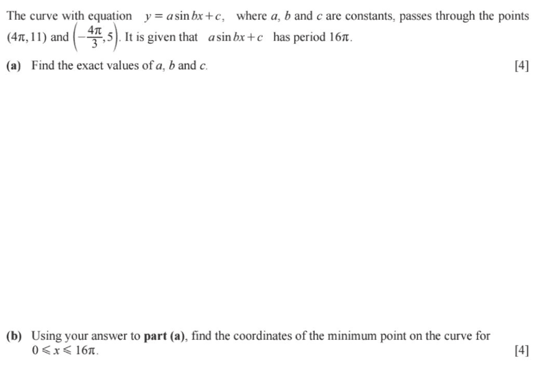

See attached.
trigonometry
This is the question...
My attempt on part (i),
##b=\dfrac {16π}{2π}=8##
##11=a sin 32π+c##
##c=11##
##5=-a\frac {\sqrt 3}{2} +11##
##10=-a\sqrt 3+22##
##12=a\sqrt 3##
##a=\dfrac {12}{\sqrt 3}##
Is this correct? Thanks...

No. Instead of b = 8, I get b = 1/8, and I get different values for a and c. Since the period is ##16\pi##, it must be the case that the coefficient of x is less than 1, not greater than 1. Apparently you didn't check your answers to make sure that you had the correct parameters.

...sine ##90^0=1## and ##sine 30^0=0.5##
ok, i think it ought to be, ...
##11=a+c##
##10=-a+c##
giving us,
##a=0.5## and ##c=10.5##
##11=a+c##
##10=-a+c##
giving us,
I don't get either of those values. Are you checking them by substituting the given points into the equation?
Initially i had,
##11##=##a sin 8(4π)##+##c##
##5##=## a sin 8####\left[-\frac {4π}{3}\right]##+##c##
which gives me,
##11##=##a sin 32π##+##c##
##5##=## -a sin ####\left[\dfrac {32π}{3}\right]##+##c##
and from the first equation, ##sin 32π=0##, and ## sin ####\dfrac {32π}{3}##=##\dfrac {\sqrt 3}{2}##
Are you certain that my earlier attempt is not correct?
True, I see my mistake on ##b##...let me look at it again...thanks @Mark44

The graph of ##y = a\sin(8x) + c## has a period of ##\frac{2\pi}8 = \frac \pi 4##.
This conflicts with the given condition that the period is ##16\pi##.

Yes. I have checked my work.

##b=\dfrac {2π}{16π}=\dfrac {1}{8}##
##11=a+c##
##5=-0.5+c##
##a=4## and ##c=7##
chwala said:
##5=-0.5+c##
I think you meant to write: ##5=-0.5a+c##
Absolutely thanks.
