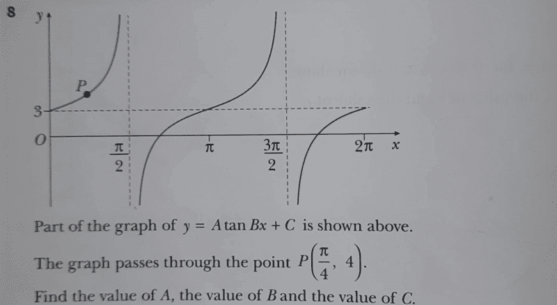

My interest is on finding the value of ##A## only. From my calculations, ##A=1##and not ##2## as indicated on textbook solution.
In my working we have; i.e ##4=A +3.##
The values of ##B##and ##C## are correct though. Kindly advise.
Find the question and textbook solution.
chwala said:
In my working
Which you don't post, so we depend on telepathy now.
But I suppose my answer would also be ##A=1## :smile:

Ok I will indeed post my working later. I'll get back on this..finishing on some chores @BvU
For tangent graphs, the period is given by;
## Bx= π##,
the period of the given graph is ##x##=##\dfrac {3π}{2}-\dfrac {π}{2}= π##
therefore,
## Bπ= π##, →##B=1##,
The principal axis crosses the y-axis at the point ##(0,3)##, therefore ##C=3##.
Using the given point ##P\left [\frac{π}{4},4\right]##, we shall have,
##y=A tan Bx + C##
##4=A tan \dfrac {π}{4}+3##
##4=A+3##
##A=1##

I agree as well that A = 1. The graph of ##y = 2\tan(x) + 3## would pass through the point ##(\pi/4, 5)## rather than the point P shown on the graph. Also, I find it odd that the problem parameters are A, B, and C, but the posted answer uses a, b, and c. That's sloppy.
