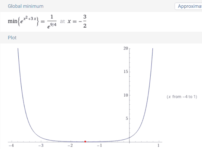

Are you certain of the minimum value ##\left[-\dfrac{9}{4}\right]##? or i am reading the wrong script! Ok seen what you meant. We have to be careful with the english here :biggrin: the minimum is actually the value ##[e^{-\frac{9}{4}}]##.
You can always use WA to check a solution:
You misunderstood what @anuttarasammyak has written.
In order to minimize ##e^{x^2+3x}## we need to minmize ##x^2+3x## which is at ##x=-1.5.##
The minimal value of ##x^2+3x## is therefore ##-2.25.##
The minimal value of ##e^{x^2+3x}## is thus ##1/e^{(9/4)}.##
All this happens at ##x=-1.5.##
