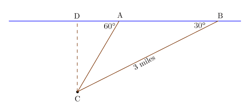

Two straight roads, which cross one another, meet a river with straight course at angles ##60^{\circ}## and ##30^{\circ}##, respectively. If it be 3 miles by the longer of the two roads, from the crossing to the river, how far is it by the ##\text{shortest}## (or the shorter of the two?)? If there be a foot-path which goes the shortest way from the crossing to the river, what is the distance by it?
1. In a right-angled triangle, ##\sin\theta = \frac{\text{opposite}}{\text{hypotenuse}}##.
2. For a triangle ##\text{ABC}##, ##\frac{a}{\sin A} = \frac{b}{\sin B}##. (The Law of Sines)
1678645745230.pngProblem statement : I copy and paste the problem as it appears in the text. I hope am understanding its wording correctly.
Diagram :
The river is shown in blue. The two roads start from the crossing C and end in A and B, making angles ##60^{\circ}## and ##30^{\circ}## resectively. The longer of the two roads CB is given to be 3 miles. Question is, how long is the shorter of the two roads AC, assuming my understanding of the problem is correct. Additionally, how long is the shortest way from C to the river, that is CD, where CD is ##\perp^r## to BA produced.
Solution : Using the law of sines (see Relevant Equations above), ##\text{AC} = \text{BC}\times \frac{\sin 30^{\circ}}{\sin 60^{\circ}} = 3\times \frac{1}{2}\times \frac{2}{\sqrt 3} = \sqrt 3 = \boxed{1.73\,\, \text{miles}}##.
The distance CD = ##BC\, \sin 30^{\circ} = 3\times\frac{1}{2} = \boxed{1.5\,\text{miles}}##.Issue : The answers don't match with those in the text. I copy and paste the text answers below.
A hint or help would be welcome. I am perplexed at the moment, given the simplicity of the problem. Or am I deceiving myself?
I get the same answer as you got. For the pasted textbook answer, I don't know how they got ##2 \frac 1 2## miles, and I don't understand the first part, which is unclear. It says either "##2 \cdot 89##... miles" or "##2 \cdot 80##... miles".

I think I have an idea. I assumed (naively) that the two roads "meet" the river bank on the same side as that of the perpendicular (CD). Is it possible that they meet on opposite sides of D? I should carry out the solution if that is what the authors mean by "crossing".
All the same, the wording is ambiguous, if you'll agree.
I thought of that, too, but I don't think it makes a difference in the length of AC.
Yes, forgive me. AC remains the same on either side. It is a puzzle. I think I have to accept the book being mistaken here.

I believe the mistake is in the 3 miles distance.
For the values of the response to be correct, the distance from crossing to river via BC should have been 5.0 miles.
You don't even need the sine rule to solve this problem since we are dealing with right triangles.
