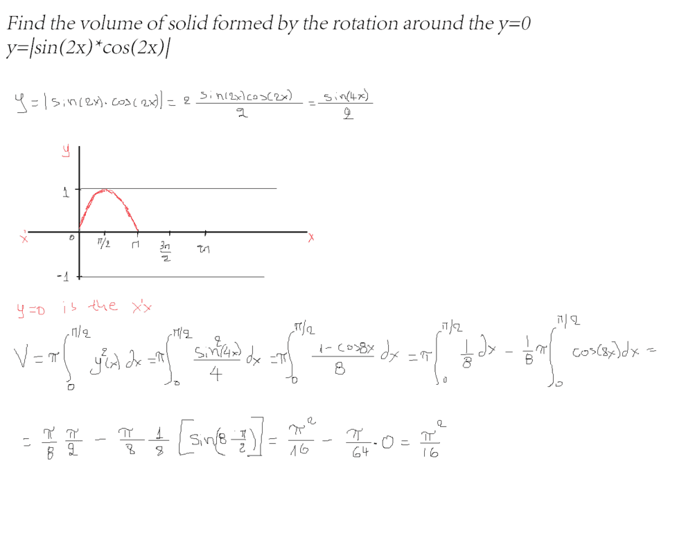

Find the volume of the solid formed by the rotation around the y=0
y=|sin(2x)*cos(2x)|
nil
Hi,
I find this...
Please tell me your opinion on this.
Thanks.

The integral itself looks right, although the graph of that function is zero at ##\pi/4##.
Did the question say to integrate from ##0## to ##\pi/2##?
Oops my mistake, it is: 0 ≤ x ≤ π
I have to fix it.
Thanks
So integrate from 0 to π: V=(π^2)/8
