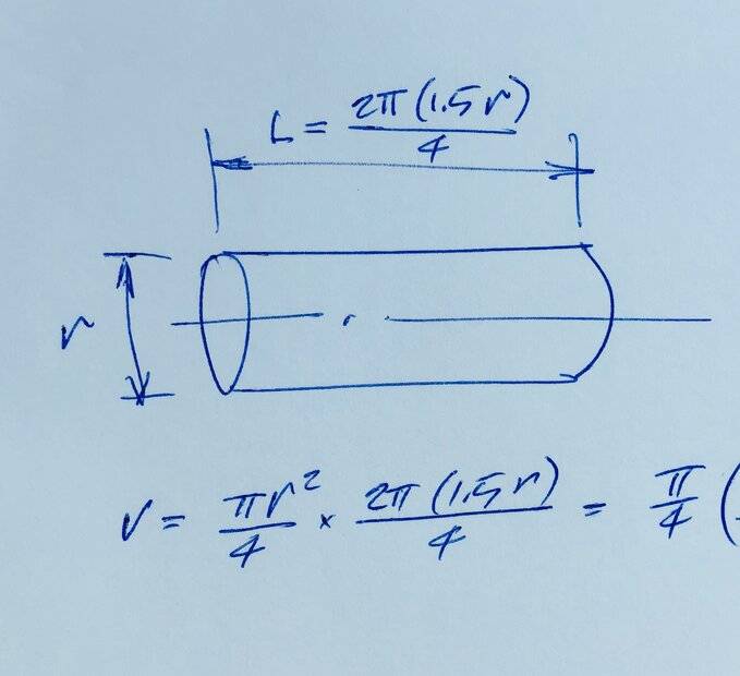

Another way to do it, leading to the same result of ##2.3562*r^3## that is shown in the book:
Straightening the elbow until it becomes a cylinder, its length should be equal to the perimeter of the center line of the elbow.
As the perimeter of that line is ##2\pi(radius~to~center)/4##, then
##Length=2\pi(1.5r)/4##
##Volume=Area~*~Length##
##Volume=(\pi/4)[(r^2)(2)(1.5)(r)]=(3/4)\pi(r^3)##

Shouldn’t there be another π/4?
Perhaps.
I am very clumsy working with LaTeX.
Handwritten sketch of a cylinder with diameter labelled r and length L = 2π(1.5r)/4, with volume V = (πr²/4) × (2π(1.5r)/4) = (π/4)(…) written below.
Lnewqban said:
Perhaps.
Your answer is correct.
The cross section area = ##\pi \text{(}\frac{r}{2}\text{)}^2##
\forall _{elbow}=\int_0^{\frac{\pi}{2}}{A\left( 1.5r \right) d\theta =}\int_0^{\frac{\pi}{2}}{\left( \pi \text{(}\frac{r}{2}\text{)}^2 \right) \left( \frac{3}{2}r \right) d\theta =\text{(}\frac{\pi r^2}{4}\text{)}\left( \frac{3}{2}r \right) \left( \frac{\pi}{2} \right)}=\frac{3}{16}\pi ^2r^3
