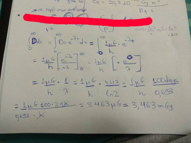

Assume that we have 137 Cs absorbed in an unknown organ. We know that the initial dose rate is 1μGy/h. Calculate the total equivalent dose in this organ, if we know that the activity is reduced exponentially over time with an active half life of 100 days.
[/B]
∫D⋅dt
∫D⋅dt= ?
I suppose that I should try somehow to solve the above, for t between 0 and 100 days, since the active half life is 100 days. But since the activity changes over time, I think that the dose rate too will change over time.

I am quite sure it does not mean that. It means that the rate halves over 100 days.
But at least your response there helped me resolve one misunderstanding: "137 Cs" means caesium 137.
So, the question is saying: if the initial rate is 1μGy/h, and it decays exponentially so that after 100 days it is half that, what will be the total number of Gy from t=0 to t=∞.
(But I do find it odd that it asks for "equivalent" dose, which depends on a factor associated with the type of radiation. Maybe the factor is 1 for 137 Cs decay.)

No, it does not say 100 days has gone by. It only mentions 100 days as a way to express the decay rate. No specific time is mentioned for the total dose, so you should take it as infinite time.

No, you know that it decays exponentially and, trust me, you are given the half life.

100 days is the effective half life of 137 Caesium

No matter, you should use 100 days as the half life in this question. Same equation, different rate.
(I believe the difference is that the effective half life comes mostly from the turnover within the organ, i.e. it gets moved out of the body much faster than it actually decays.)

How does that seem as a solution? Do you think it is correct?

superduke1200 said:
How does that seem as a solution? Do you think it is correct? View attachment 220763
Looks right to me.
Fine! Appreciate your time a lot
