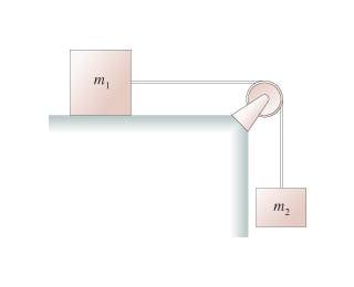

A block of mass m1 = 39.2 kg on a horizontal surface is connected to a mass m2 = 21.1 kg that hangs vertically. The two blocks are connected by a string of negligible mass passing over a frictionless pulley. Assume that the horizontal surface is smooth.
(a) What is the acceleration of the hanging mass? (Enter the magnitude only.)
(b) Determine the tension in the cord. (Enter the magnitude only.)

W1 and W2 are the weights of the two boxes so W1= m1 * g and yeah it had an image with the problem but I also drew separate images of just the boxes and their forces.

On the drawing for m1 you should then see that the only force that influences the horizontal acceleration is T.
And for block 2 you don't have T = W2 (because that means equilibrium, and therefore no acceleration).

m1 is being pulled down by gravity with a force W1. That is compensated by the surface that pushes up with the same force in the opposite direction. So the block doesn't accelerate in the vertical direction. There is no friction, and the only other force on block 1 that I can think of is the tension from the wire. That tension accelerates the block in the horizontal direction. We can write down an equation for that. It doesn't involve the weight W1, but it certainly has to do with the mass of the block. That was what I was aiming at in post #4. The distinction between weight (a force) and mass (a mass :smile: ) is important in physics. In everyday life we mix them up all the time.
The wire is taut, so the length is fixed. So the acceleration of block m2 is the same as that of block 1. But the force balance looks different. That is the second equation. Two equations with two unknowns (a and T). Bob's your uncle, piece of cake, etcetera (meaning: this can be solved) :smile:
